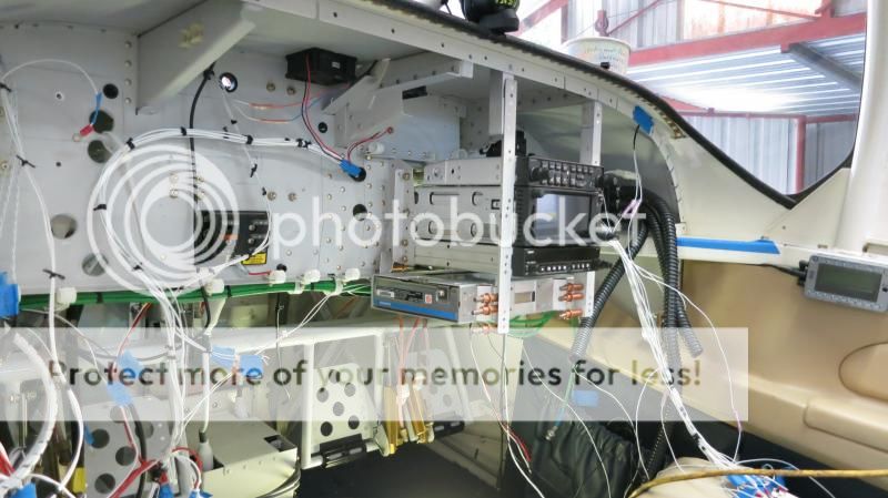

Mounted my GTX23ES on the bulkhead itself, on the aft side, antenna cable about 2' long, works perfect.
Walt, do you have a picture of how you mounted the transponder? That is a lot of weight and I am having difficulty picturing how one might mount it. The bulkhead itself seems too flimsy for the weight, so I am thinking you used some stiffeners in the installation. Did you mount it up near the turtle deck, or down near the floor? I am committed to putting my transponder in that location; would appreciate the benefit of your experience.

Rich,
If you can wait till Friday, I will take a picture of how I did mine. I mounted rails the width of the panel on the bottom to hold my transponder and VPX. It was a pain, but very sturdy. PM or email me and when I get home Friday, I will send pictures.
