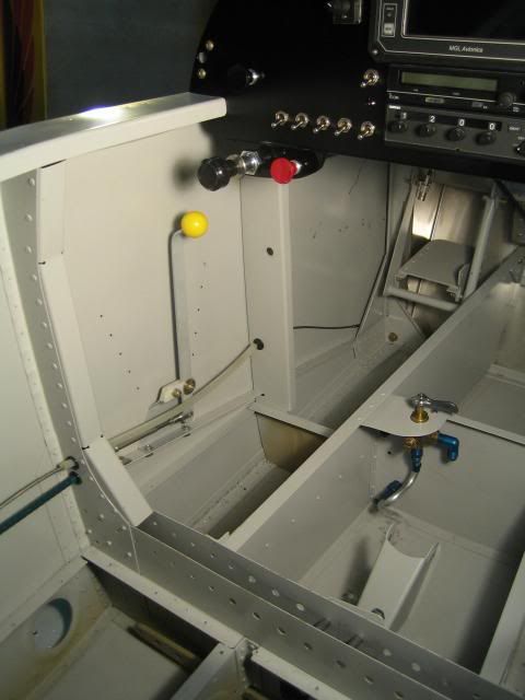

If I understand you correctly, drawing #39 shows the angled component, but doesn't give any dimensions for placement. These photos are the best that I have. The aft end has some metal removed, so it overlaps the doubler surrounding the spar opening in the fuse sides. The RV-4 drawings are really great, but do have a few small omissions.

OK so much for going from memory. My earlier comment should have said the aft end was the one that needed milling to lie flush wit the skin. And it does technically attach to the wing spar bulkhead as it is riveted to the piece that frames the spar opening. The previous pictures should make this clear?.

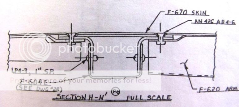

If it's like the RV-6, that stiffener is too thin to "mill away".
This is what the RV-6 plans show at the similar location at the main spar bulkhead - a notch and a joggle in one side of the angle -

Posts: 624
The -4 is different. There is a single 0.063 plate that the angle has to overlap. So milling (IIRC correctly the plans state "file away material as required" or something like that. Since the angle is 0.125 thick you remove half (or in practice a bit less to get the angle to lay flat against the plate piece of the bulkhead assembly and the fuselage skin.
