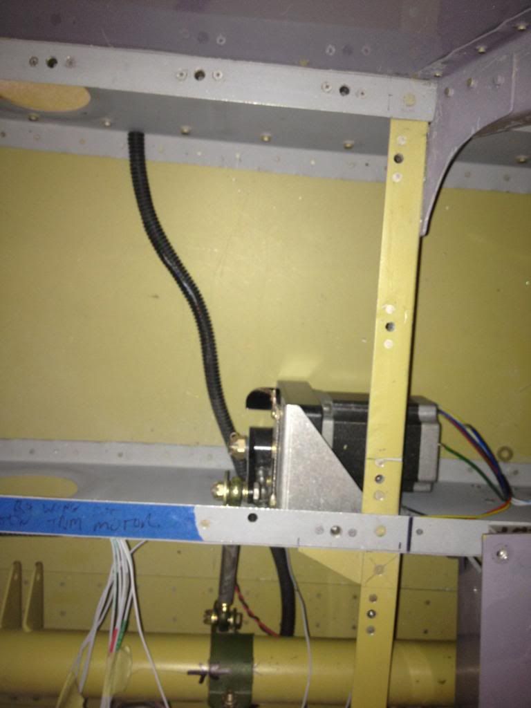

Hallo.
I would like to install both roll and pitch Dynon servos on my -4.
I found here a message suggesting to use the -6 roll servo bracket. This is installed on the fuselage. The -6 Dynon drawing shows a different column, so I was wondering what could be the actual connection.
On Dynon forum it is said there are on VAF photos on such installation.
Does anyone has them?
Thanks.

I put the roll servo in the stick well with a short rod attached to the stick bracket. I did reinforce the side of the stick well with a backup plate. Works great.

I installed the roll servo using the RV-6 bracket. I fab'd a bracket on the control column that copied the aileron push tube connection located so the servo didn't interfere with the passenger footwells. Since I don't own a welder I had the bracket welded on by a local welder. I'll try to remember and post a pic or two this weekend.

I installed both pitch and roll A/P servos in our -4. I used the mounting bracket from a -6 mounted on the floor. I got the bracket and collar for the torque tube from Stein. I mounted my roll servo on its side. Works great

I mounted the roll servo outside of the box containing the sticks. It is mounted just behind the rear seat foot wells I installed. I got the pushrod from Dynon and it goes through a hole in the longitudinal floor former. It is on the right side.

Default Sorry just seen this thread.. Done my 4 several months ago
RV4,,, I have the Dynon D180 and did the Dynon AP servo's.
Here are some info and pics fill free to pm with any question.
List of what I bought from Aircraft Spruce:
10-03567 DYNON AUTOPILOT GENERIC $25.75
SERVO MOUNT KIT
1 11-08358 7274-2-5 KLIXON CIR $17.50
BREAKER
1 10-03560 DYNON AUTOPILOT PITCH $795.00
SERVO FOR RV 4 / 8
1 11-00031 INFINITY MILITARY STICK $199.95
GRIP RIGHT W/ FLAP / BRAKE
SWITCH
1 10-03561 DYNON AUTOPILOT SERVO $738.00
SV32 STANDARD ARM
Total $ 1776.20
Aft Bay Before Servo:
Aft Bay After Servo:
Before Wing Servo:
Wing Servo Bracket had to make it:
Wing Servo installed:
