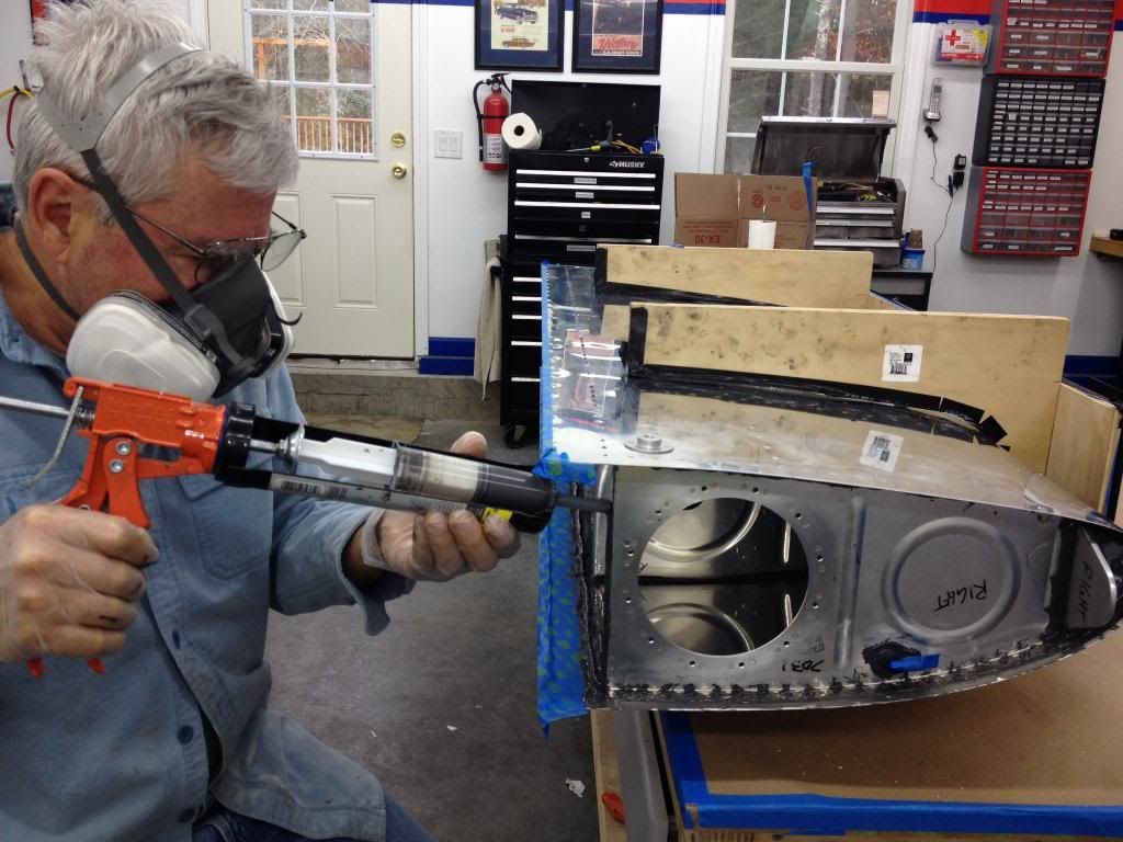

Kinda like putting decorative icing trim on a cake.
Actually, I found a cake icing kit at a garage sale and used that. It had these syringe-like shooters with several tips and it only cost me $5. I used half of the kit on the left wing and threw the pieces away when I was done and used the remaining half on the right tank and then threw them away. The best 5 bucks I've spent so far...

Good suggestions all. I'll add one that I found useful. I used the large veterinary syringes to apply sealant, but found them very hard to squeeze by hand. maybe it was because of cool temps in my shop at the time, but eventually I found it was possible to chuck the syringe into a standard caulking gun. That made the squeezing much easier.

my best tip is to mix 1oz at a time, use large popsicle sticks (purchased at a craft store) to mix, etc... and scoop it into the corner of a baggie. Twist and tape off the excess baggie and then cut the corner. You can then hold and squeeze out just what you need, where you need it. Just like an icing bag.
I also use the acid brushes cut to about 1/4-1/2" so they're stiff to spread the sealant where I want it.
Use lots of sealant to cover and fillet between ribs and skin!
I would NOT seal the cover with proseal. (tried it... was extremely hard to remove) I also didn't have good luck with cork gasket (even with proseal on each side) It leaked repeatedly. I'm doing a tank repair now and will use the "access panel" version of proseal found at skygeek this time around. Supposed to be less sticky.

My wife and I put on the old clothes and I already had the ribs fluted and the stands made. Old clothes because that pro seal stuff will jump out and attack you and everything else in sight.
I did the initial. With the filler tank install and the sump drain, and vent line.
We buttered up one rib and clecoed them in place then applied pro seal to each rivet and then riveted it in place and continued until we got them all in. Then we put used a Popsicle stick and edged the ribs. We initially did every other rivet on each rib and then came back and put in the missing rivets before moving on to the next rib Then we put a dab of pro seal around each bucked rivet using bamboo skews and then cleaned up all the excess pro seal on one tank and then started the other.
The next day we did the back plate and the sealed up the rest of the tank it took more time to clean the cleco's and tools and the ribs up than it did to rivet them.
We used the cork seals and even though our latex balloons did not deflate even after 4 months. As soon as I filled them up with fuel one leaked at the cover plate and sending unit.
I removed the cover and the cork and just used pro seal to seal the cover. No more leaks. I did both tanks .
