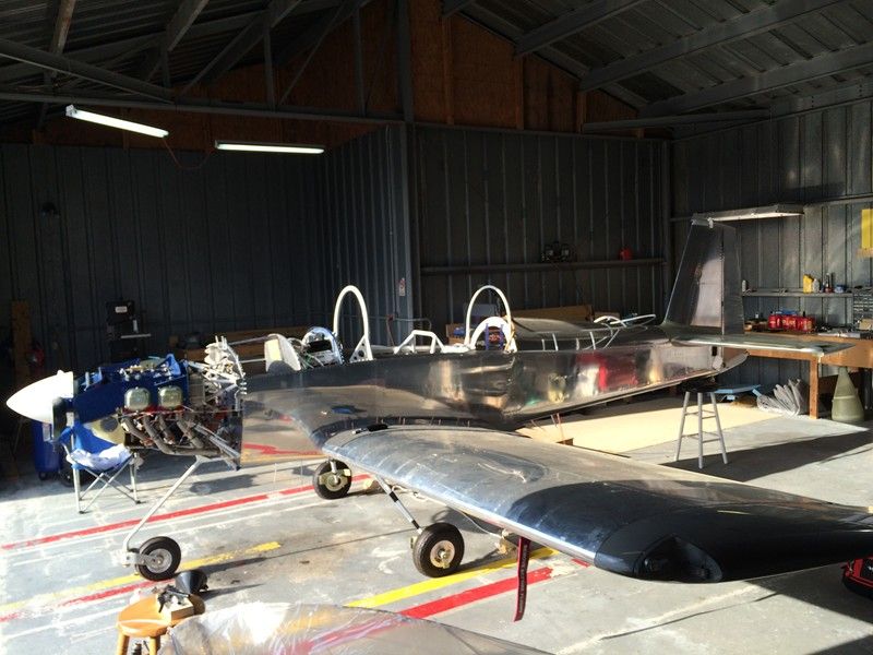

Okay, I normally don't put anything up except at the end of the month but today was a special day. The usual suspects were over to help fit the wings and after a little bit of white lithium grease on the spars, they slide right in ... much better than the gear. Eight 3 oz fishing weights hung down the leading edge of the wings acted as plumb bobs and a laser line level was used to sight the sweep while the iPhone declinometer helped to measure the incidence (isn't modern tech wonderful?). Surprisingly, the aileron push rods needed NO adjustments and only minor trimming on the flaps. Now to finish the fairings then have the crew back to remove the wings, deburr and put them right back on ... permanently.

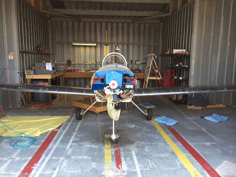

While we got the wings on last month, I waited to permanently attached them with the bolts until I knew for sure I no longer needed access. After deep freezing the bolts for a couple days and a little bit of grease, only a medium-sized "influencer" was needed to get all 8 CT bolts plus the 2 non-CT bolts per side in place. What took some time was getting the nuts on the bolts on the front side. My hands are not small and the space is tight. NOTE: There are two bolt/nut combinations on the bottom that you must use care when tightening because of the space to the gear mount. Do NOT start the nut on the bolt then hammer the bolt in further ... the nut will tend to get destroyed. Yeah, that was fun backing that bolt back out.
Once the wings were on, wiring and pitot/fuel lines could all be connected. I had Aircraft Specialty make the fuel hoses and I couldn't be happier. I originally screwed up the order but they swapped it out no problem. These guys are awesome. I did learn they will send you fittings that can be used with a plastic tube to determine the EXACT length you need. Next time.
One of the "fiddly bits" was to set the breakout force for the nose wheel. A digital fish scale worked great.
Over the weekend the first set of fluids were "transfused" into the aircraft. After much hydraulic fluid on the hands (and floor), I learned how to bleed brakes.
Finishing up the baffles and fitting the cowling has been slow progress but I am hoping to be complete by next weekend and ready for the first engine run.
Like others, the Superior IO-360 with the Airflow Performance fuel control doesn't quite fit the stock IO cowling. A hole in the bottom side was necessary and I will glass it over later in the week.
I am sure we will come up with an appropriate modification name.

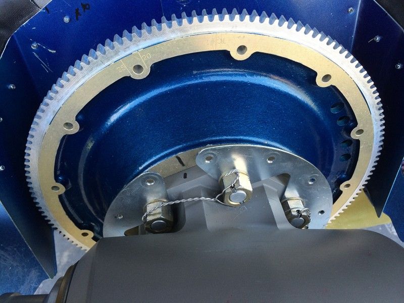

Attempted the first start over the weekend but while there was fuel flow and rotation, there was no spark. Chasing wires I found my P-mag switches were grounding out the power so for now the lines are connected directly until I can find the fault in the switches.
With the crew back in palce yesterday, we cranked up for real.
http://www.youtube.com/watch?v=u8FdV...r#action=share
Only two minor leaks that hopefulyl will be solved with tightening the connectors. I say hopefully because during the second run, there was a loud "clunk" followed by severe shuttering during cranking ... which can't be good. A little investigative work found 7 teeth on the starter ring sheared off. as it turns out, the starter engaged then froze.
The good news ... Ameritech, who built the engine, is going to help out with fixing the ring and replacing the starter. While I won't make the projected completion date before I move, I will be able to finish within the month.
More to follow ...
(update)
The new starter ring and re-installed prop.

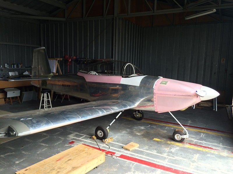

After the "minor" set-back, movers, and lack of internet until now (new neighborhood and fiber had yet to be run), it has been a long time since I have had the opportunity to post my status ... so much has changed.
Jumping right in -
Flap and wing fairings, step, and most other external things are complete.
The N-number will eventually be 12" high but for now letters from Lowes work just great.
I went the SikaFlex route for the canopy and windscreen and while apprehensive at first, this stuff was so easy to work with and cleaning up the excess was a snap since the agent only sticks to the primer. A little effort masking went a long way in making a nice, solid seal.
On to the front end ...
I did swap the earlier interior "blue" lights for more night-friendly red.
My mentor and right hand helper gave me a special chock as a memento of the occasion of passing the FAA inspection. The squawk list was small (loose jam-nut in the tail, a nut on the battery solenoid, etc.) and all-in-all a painless experience mostly because he kept me honest throughout the build. Thanks Jim.
So on to Phase I. The battery was about to die so the starter didn't quite move the prop and now my kids are here for a month. I can't wait to get out in the last weekend of August and get those first few flights out of the way. I am hoping to get the 40 hours flown off in a timely manner and FINANLLY move the TARDIS up to it's new home at Martin State north of Baltimore.
