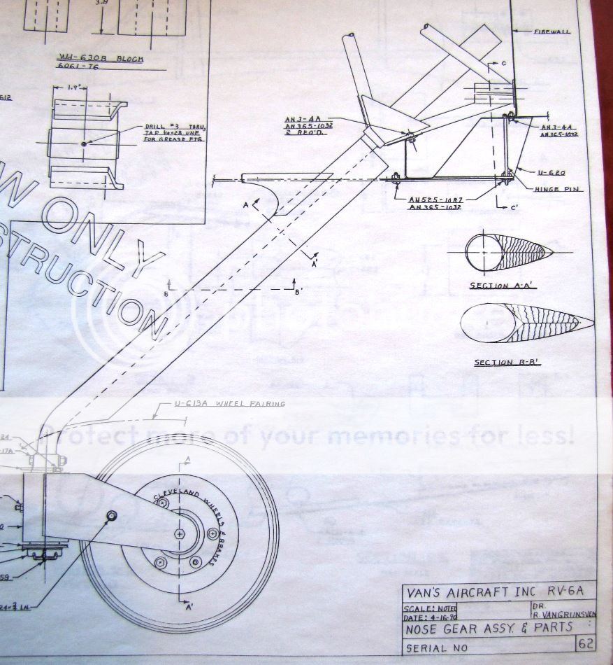

Originally Posted by rhill View Post
Thank you Bob for posting this thread. There have been more than a few Anti-Splat accidents since there introduction. Trends are starting to emerge.IMHO,The brace alone is not enough.The sealed bearings and associated upgrades as well as the skid plate under the retaining nut are required.During construction and on inspection the fit of the leg&socket is another critical point of concern.The size of the nose wheel&tire as well as balance also play a roll.I can't help but to wonder if a hard wood dampener should be added to the mix.
Any Thoughts?
RHill
Just like the early -6A plans that showed a wooden dampener glassed and bonded on to the nose gear leg and was the only aerodynamic fairing involved.
IIRC this moved the breaking point to the top of the gear leg, and maybe corrosion issues occurred when foam was used instead of wood.
Gil Alexander

With the Anti-Splat brace clamp mounted center span underneath.I'm thinking two similar clamps holding a wood strip across the top to dampen the oscillations of the leg.

I've read these threads with passing interest as I don't fly an A model. But the issue has got my curiosity up and am searching for an answer. One problem seems to be lack of hard data and an understandable amount of angst.
But it seems to me that if the nose gear is indeed "folding up" then there can only be on way for that to occur. Looking at the drawing above it would seem that in order to apply sufficient force in the "x" or horizontal direction to the gear leg to fold backwards the leg must be bent enough such that some part of the assembly holding the front wheel/tire must be impacting the surface. In other words "stubbing its toe".
This could be caused by flexibility of the gear rod being too great, locked up wheels, gopher hole, etc. The various solutions seem to attempt to address all three likely causes with varying degrees of success. With no intention of slighting anyone I tend to want to discount the notion that this would happen on a smooth roll out. Things happen so fast that the eyewitness probably can't distinguish between events that occurred prior to the fold up and the fold up itself.
Something has to be catching the front of that gear and then Isaac Newton takes over. Even at 20mph the force generated by a 1500lb vehicle hitting something is over 20,000 lbs if I did the math right.
But enough of that - how to fix? Would seem solution would require a design where the gear is constrained (or encouraged) to deflect more in the 'y' direction and less in the 'x' direction to prevent rotation of the front such that it catches on terra firma. There are much more qualified engineers than me on here and I'd appreciate if someone could point out flaws in my reasoning.
