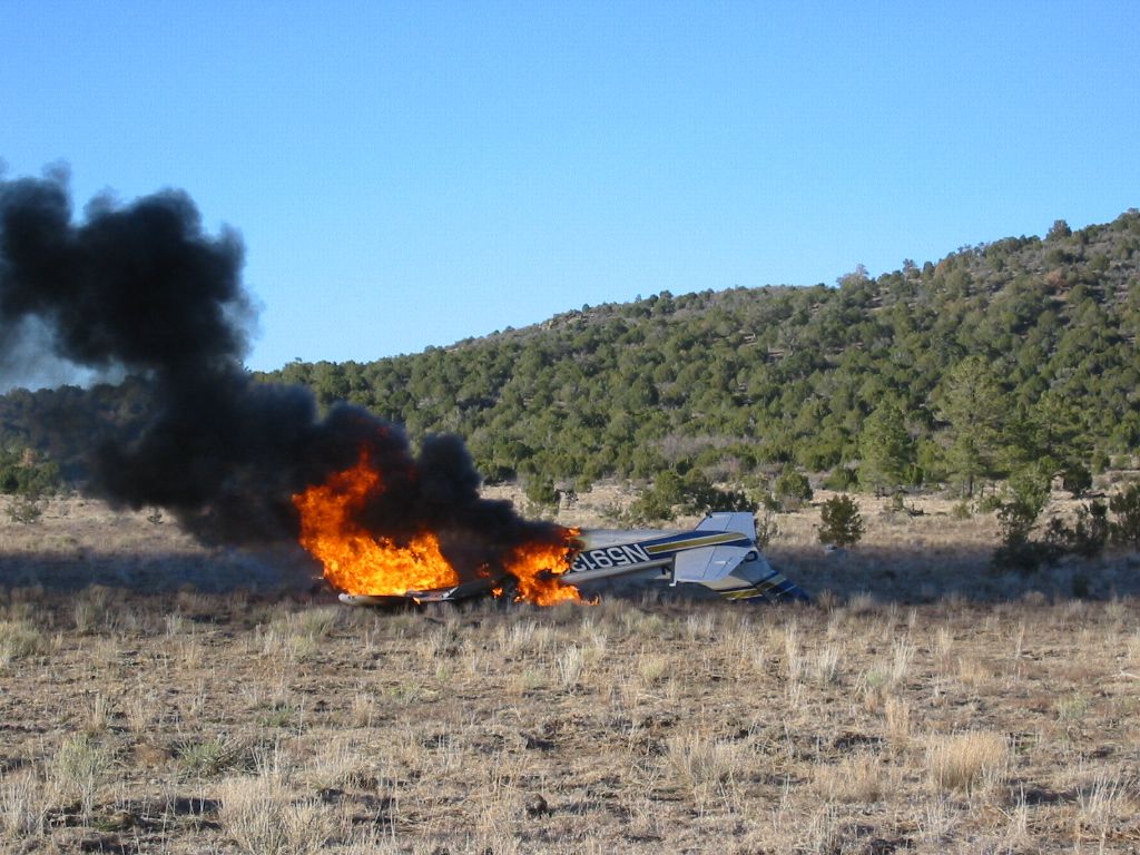

The lessons you covered when learning to fly.... about getting on the ground as SOON as possible, are all valid. And I mean soon. This C210 filled with smoke as I climbed through 3000AGL. I spotted a clearing in the woods and slid it on. Gear up. Opening the windows, kicking the doors ajar... all had very little positive effect. And pull those seat belts as tight as you can. Unfortunately, the little canisters called SMOKE HOODS were recalled from the market. I would purchase them again for the RV if I could.
[IMG][/IMG]
This original post was car related... so I apologize if I hijacked it a bit.
I have a collection of graphic photos as the plane burned, but I think one is enough to get the idea. AV Gas and other fluids in our RV's are highly combustible. That is just an academic term, until you see it a few feet from your face.
Be prepared with a plan... and hope you never use it.

Scary stuff, guys. Here's a question for all of you: do you think anything could have been done to snuff out the smoke/fire quickly? Obviously this doesn't apply to the Porsche, but I always planned on killing the master switch immediately and pulling out the fire extinguisher at any smell or hint of smoke. Was the electrical system left on in the 210 or did shutting it down not help?

On the turbo 210, I shut everything off at onset of smoke. That was no help. Had to turn on master and boost pump to clear a line of pine trees on final, since the heat in the cowl vapor locked the fuel. Only for about 3 seconds to get some power. After that, just calculated a new flare height since the wheels refused to go down. The sound of the prop grinding down is one that sticks with me. After a hundred yard slide, it flipped over. In prep for the landing I had my pax jump over into back seat and buckle in. Turns out he was the one that had minor injuries from the lap belt. Mostly just bruises.
It burned to scrap metal, so NTSB did not find the cause of the fire.
Went out flying the next morning in my Luscombe. Gotta stay in the saddle or it will spook you.
