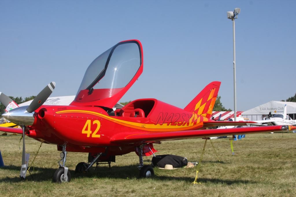

Originally Posted by GeneL View Post
Hint: It was an SX 300. I think he just won g-champion for S-N-F 2014
Ahhh, gotcha.....I remember Judging this plane at Oshkosh last year....very nice . Since this is an 'RV' site I only looked at the 'RVs' that won awards.
That said....'N numbers' are 'N numbers' so I'm posting a pic of the plane so folks here can understand what the FAA at Sun 'n Fun deemed as "contrast problems" (as quoted in previous post). I didn't look up what the rules are regarding 'contrast' but I'm sure someone with more time on their hands will do it for us .
Personally, I can see the number quite clearly but evidently others (with ID badges) view things differently.....as has been discussed. Matter of fact the 'N number' is a lot clearer to me than the little yellow RV under the spinner .

Whatever. Both those numbers fail the smell test under part 45.
Agreed. Maybe we need more detail like in the UK...
