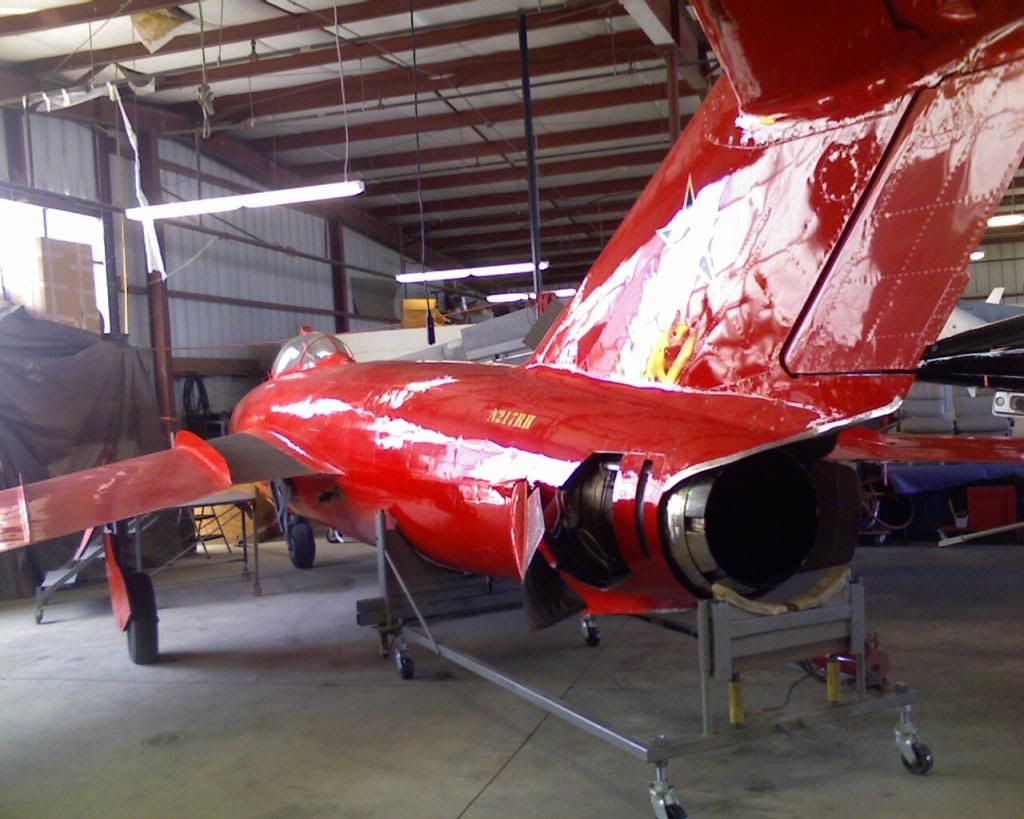

Wonder what this cruises at......
Old 04-04-2014, 10:46 AM
krw5927 krw5927 is offline
Join Date: Aug 2010
Location: Wichita, KS
Posts: 1,958
At least 3kph (kilo-bucks per hour).
