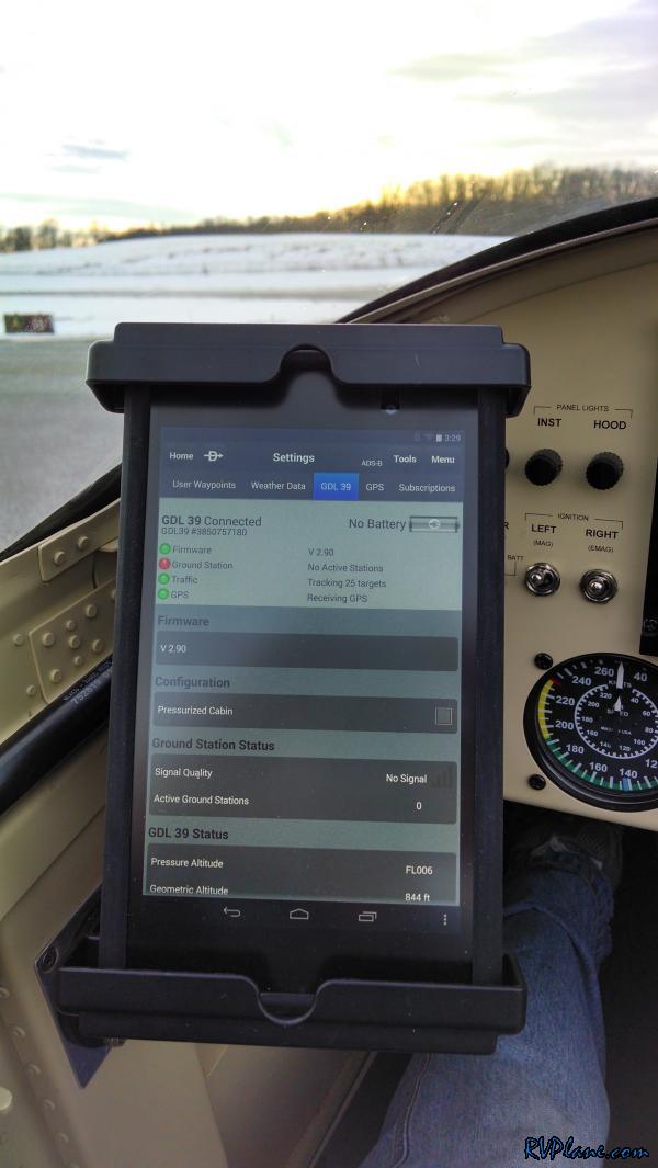

Originally Posted by grayforge View Post
Taking advice from comments on this thread, here's my panel version 2.0.
Version 2.0
A few things to be aware of with the iPad mini or tablets in general in the cockpit:
1) The iPad mini isn't viewable in the landscape orientation when using polarized sunglasses.
2) The screen isn't all that bright and washes out easily in the sunlight. It also tends to overheat and shutdown in direct sunlight.
3) Being located all of the way on the other side of the panel could make it challenging to use.
4) Tablet technology changes so fast you may not want to commit valuable panel space to a tablet.
I use a Google Nexus 7 in a RAM mount, attached to the F-704K upright cap strip. It works great!
Concur w/ above, and I'll add:
5) Glare is an issue, and flat-to-panel installation may be disappointing.
The aircraft environment was probably not a design requirement; sight angle and interior/exterior reflections are an ongoing challenge.
Articulating mount, and matte anti-glare coating have helped me; YMMV...

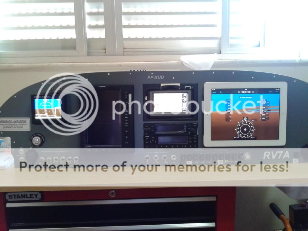

Old 05-05-2014, 08:56 AM
Guilhermepilot's Avatar
Guilhermepilot Guilhermepilot is offline
Join Date: Jan 2013
Location: brazil
Posts: 316
Default panel is complete
