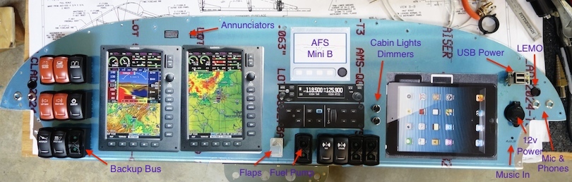

Originally Posted by grayforge View Post
Thoughts on the panel?
Thanks!
Russ
Here are some thoughts:
1. Don't mount the iPad, they age off too quickly to make a permanent part of any panel.
2. Mount the headset plugs on the sides, below the rail so the wires just drop along your legs and don't get caught in the canopy.
3. Move the flap switch to the right so you don’t have to move your hand from the throttle to raise or lower the flaps.
4. Dump the annunciators, your EFIS will have all you need built in.
5. Go with the Dynon D2 rather than the AFS Mini B. The reason is you can move it around as needed and you won’t take up your much needed radio stack space.
6. If needed, hide the USB ports behind the panel, out of the way and out of site.
7. Install two power ports. You will be surprised at how many things you will plug in to them.
Finally, I don’t know if it is because this is a mock up but your panel just looks overly complicated. Most likely because the switches look like they are sized for Andre the Giant.
Think about arranging your switches by phase of flight rather than function. Thus put all the switches you will need for takeoff and landing close together; taxi & landing lights, fuel pump, carb heat, etc. Starting switches can be grouped together, away from the others so you don’t accidently turn off your ignition in flight. Oh, where are your breakers?
Bill R.
O-360 w/ dual P-mags
SC86 - Easley, SC
www.repucci.com/bill/baf.html
  #813
Old 03-17-2014, 04:16 PM
grayforge's Avatar
grayforge grayforge is offline
Join Date: Dec 2011
Location: Kirkland, WA
Posts: 886
Bill:
  1. Good point about the iPad's form factor becoming obsolete. I do tend to stay on the bleeding edge of computing.
  2. Exactly where below the rail are you thinking for the headset switches? I was also thinking about placing them between the seats somewhere.
  3. Flaps: Maybe I don't even need a Flap switch on the panel since I have dual Infinity stick grips.
  4. Annunciators dumped. :-)
  5. I understand what you're saying about the D2 vs Mini B, but I already have the Mini B on the way and I really liked what I saw with AFS' other equipment at OSH.
  6. I'll leave the USB ports on the panel for ease of access, with so many devices now USB powered.
  7. I did buy a 2nd Cig Lighter style Power Port. I can add that.
  8. I'm reconsidering the RockRacks more. They'd be fine on a much bigger panel.
  9. Breakers? They're in the VP-X. Though if I have an emergency bus, I'll need a few. Or fuses.
Thanks!
Russ
Bill:
See picture above ^, that was the location I was thinking about. Works great as the wires lay right along side your leg and you can reach the plugs, if you need to and you will be surprised at how many times you need to.
Dump it. You are adding complexity (and weight). These planes land just fine without flaps, if it comes to that.
No big deal. You will be happy with the Mini B.
No big deal. I had my USB ports hidden on the sub panel and they were easy enough to get to.
I installed a nice double marine powerport that I bought at West Marine but I cannot find it on line. It looked like a this.
In searching for it, I found this double plug with USB ports that looks it could be modify to fit nicely in your panel (remove the clear cover?). (They also make triple plugs, which wouldn't take up much more space.) Originally I had one plug wired to the always hot bus and one to the avionics master. Later on I rewired them both to the always hot bus and used the breaker on the avionics bus for something else.
Good luck with designing your panel! I really enjoyed this process!
One more suggestion, take your full scale panel mock up and put it some place where you will see it every day. (Mine was in front of my stair stepper.) You will find you will move things around until you are happy with it.
PS. These panel reviews shouldn't be in this thread, only finished panels should be displayed here. You might want to cut this out and put it on it's own thread.
