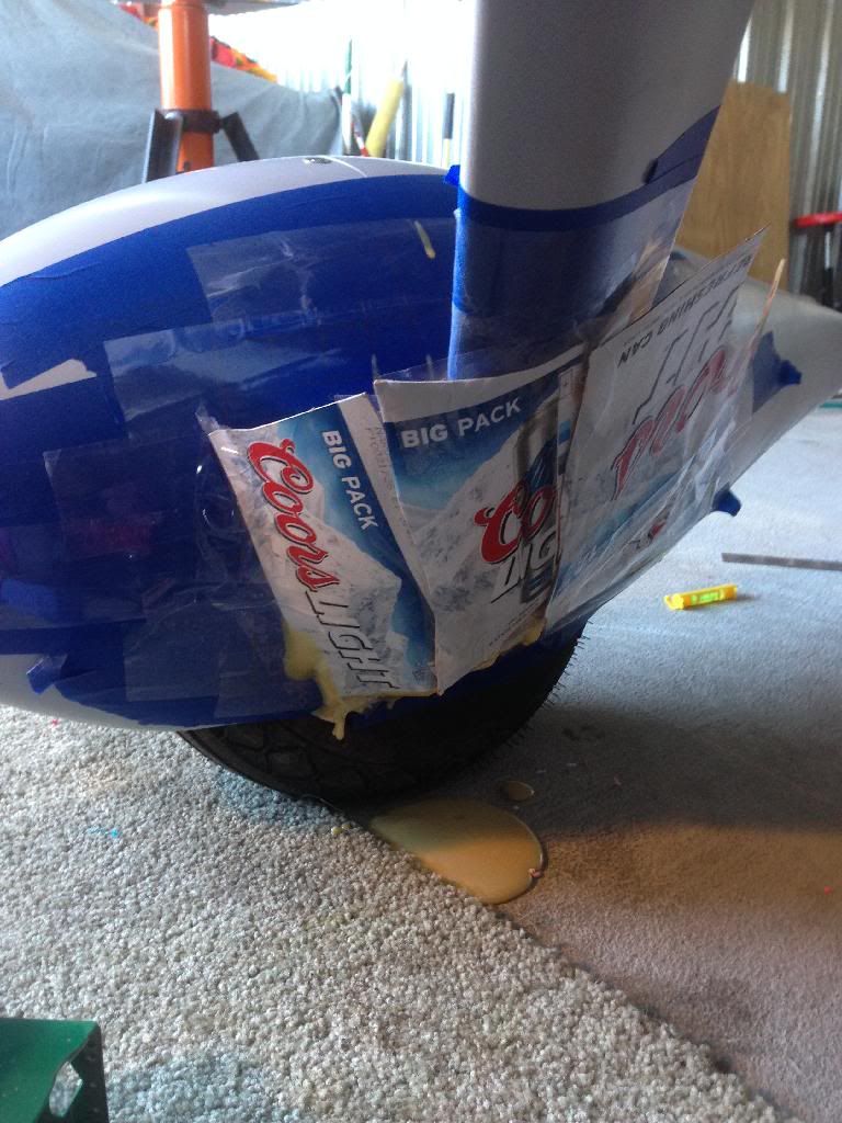

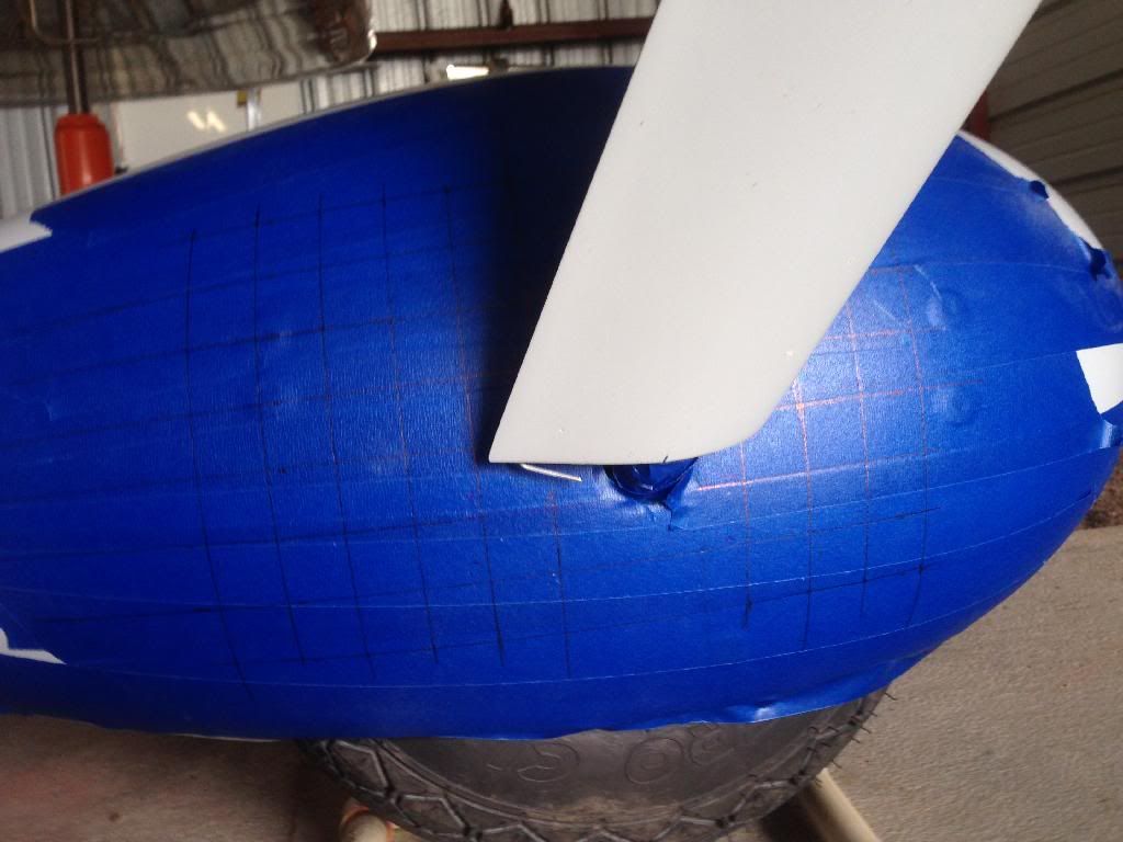

I drew a grid on the wheelpant, I have yet to use it...

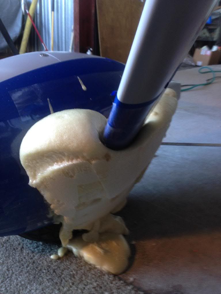

I wanted to try some pour foam, I made a **** so to speak and poured away.
Ended up with this.
It would have worked great (I think) except I covered everything with clear packing tape prior to pouring the foam. It sanded really easy but when it got down to 1/4 inch thick it just chucked off because of the slick tape.

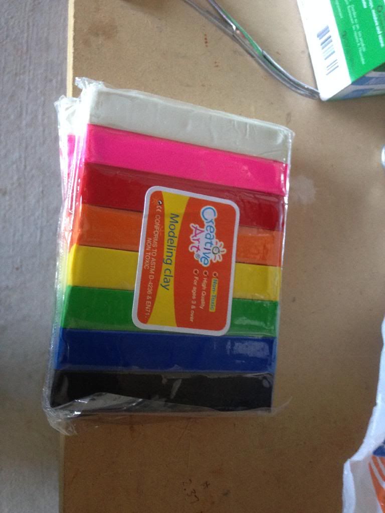

I went with plan B, modeling clay for Hobby Lobby which was way cheaper than the pour foam (2 packs was just enough).
It took me a while but I finally figured out what I was doing. I formed the lower fairings mostly with a couple on pice of 3/4 PVC. I tried to extend the leg fairings into the wheelpant and than radius it onto the wheelpant. I also tried to keep a blunt forward face with an extended trailing edge in parallel with the leg fairing trailing edge. It was in the 40's and I used my heat gun to help mold the clay.

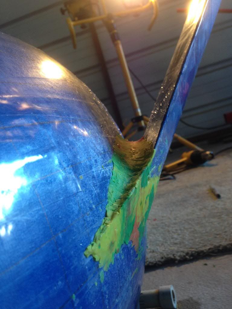

I made a pattern for the trailing edge of the upper intersection fairing.
I made 2 metal trailing edges out if .032.
I taped the trailing edges in place and jammed some clay around them.
Not a quick process, I sent roughly 7 hours on the hanger floor forming these transition fairings.

I needed to redo my intersection fairings for the right side since the right gear leg fairing was mis-aligned. I cut the fairings close to the gear leg and fuse/wheelpant transition and taped them in place. I used little strips of fiberglass to hold the new shape.
I pulled them off today, ran a bead of flox followed be a layer of glass from the inside of the cut.
Psyching myself up for the sand-fill-repeat...
