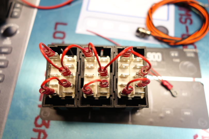

Hmmm... this talk about the mongo RockRack switches is good food for thought. If I want to stay simple and light, standard toggles may be the way to go.
There's a fair amount of complexity in illuminating the 2 RockRack LEDs independently. Below is a photo of the wiring needed to switch the lower LED on & off on a 2nd pole. Not shown is wiring for the negative side of the LEDs and the wiring of the item actually being controlled by the switch (to VP-X). Not exactly the definition of simple...
Speed Is Life
