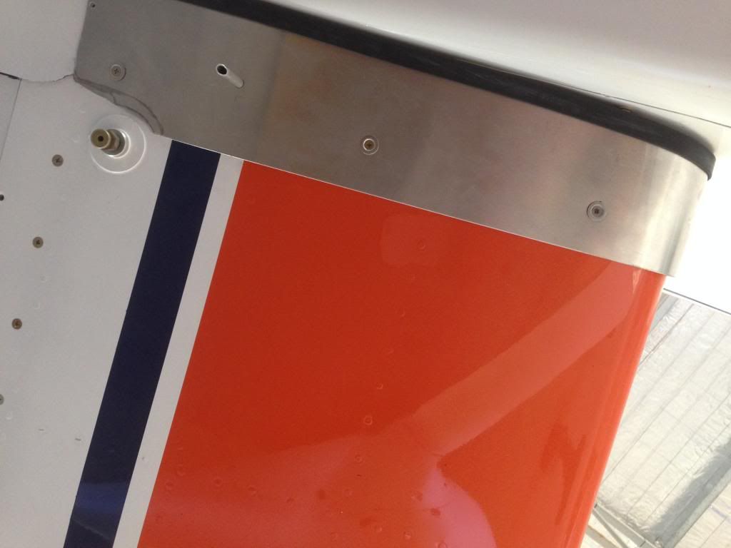

  #17
Old 03-12-2014, 05:43 AM
Derek Derek is offline
Join Date: Jan 2011
Location: Sydney, Australia
Posts: 86
Default Here is my unfinished underside
Need to trim a bit more around the drain and add a grommet to the vent line.
  #18
Old 03-12-2014, 08:00 AM
nauga nauga is offline
Location: AOTP
Posts: 192
Thanks Derek, that's really helpful. The part I was curious about is in the top of the frame in your pic where F-451 rounds the corner of the fuse.
