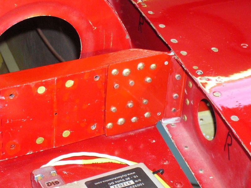

here is what I found today. notice the crack only goes as far as the paint line where the rib flange touches the spar web. the crach appears to not have even continued under the rib, much less to the rivet hole. so much for worrying that the crack went thru all the rivet holes!

Default SB 01-31-31 completed
I have finally completed the installation of the HS doubler plates. As a non-builder, it was a great experience. I bought the necessary tools, and as a back up, TWO SB kits (which were ultimately needed). I learned much more about riveting, even though I had taken the EAA sheet metal course, and became an expert at removing improperly installed rivets. I thank Chuck Wilson, of Hotel Whiskey aviation (builder of the Safer Air Extended Range fuel tanks), who coached me when I was struggling. Here are some of my observations:
1. I found the bolts for the rudder counterweight loose, and had to drill holes in the fairing to reach them. This I discovered when I was shaking some debris out to the rudder. As the aircraft ages, it appears that the lead weights "flow," loosening the bolts.
2. The use of the type of stand that John Thocker at Redline when working on Jerry "Widget" Morris's aircraft was invaluable. It neatly held the HS while the rivets are installed.
3. Inexperienced builders like me need an extra supply of rivets, as many mistakes were made, despite the EAA course,.
4. It is critical to get eight rivet holes that go between the angles located so that they can be bucked properly. It is very easy to get the holes too close to the top or bottom angle.
5. The information that was provided by VAF members was invaluable. I truly appreciate all those who went before who shared their experience.
6. It took me about 50 hours to complete the SB, reflecting my lower experience level. Several hours of that time were spent just looking, fitting, and studying how to do the SB. Obviously experienced people will do it in half the time that it took me.
