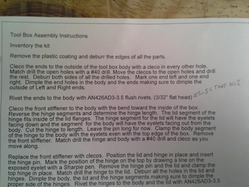

Yesterday was a learning experience. I have had plenty of experience building other things such as cars and custom motorcycles. Bucking rivets is a little different and in short, I need more practice before bucking the "money" job....
Used my soldering iron to trim the blue plastic. I had to file the tip as not to score the end pieces.
Match drilled.
Dimpled.
Here are my dimple dies. What tool is used for these (and do you have one for sale?)? I had to convert my drill press to an arbor press for the end pieces and I used channel locks to dimple the box.
My first rivet ever!
Back side.
Pow! First casualty.
Second casualty.
After drill out and replacement. I did find that using a center drill, commonly used by machinists, was a great way to start a larger hole in the rivet head before drilling through. I also need a rivet cutter...
Pretty time consuming process but very fun. I'll finish this project and buy another tool box and probably the other practice project.

For those dies you either need a c-frame dimpler, DRDT-2, or a pneumatic squeezer. For the record, to my (relatively inexperienced) eyes, that looks way under dimpled. Definitely, not the crisp hole you are looking for.

I agree. I wouldn't start another practice kit until you are set up for dimpling with one of the 3 items mentioned here.

My advise is find a local builder and spend an hour learning basics. You will find out pretty quick which tools you want/need and get valuable experience using them.
As far as the tool box, the drill press and pliers won't give you the force needed. You need a C-frame or hand squeezer or both.
Your profile shows you as a CAP member. Their shop may have the tools and skills too.

As a side note, my first tool box was pretty motley. It's amazing how much better the second one came out. I was feeling pretty confident heading in to the airfoil practice kit and found completely new ways to muck it up. I'm pretty sure you shouldn't need a rivet cutter for the practice kits.

There are marks like these around the world in different places on aircraft! You just have them where you can see them. There are some pretty good rivets in there too! The drill press can not deliver the leverage and force that a hand squeezer does, so the dimples are under formed.
The tool box is a perfect learning opportunity. Welcome to the world of RV builders.

The posts above are are all good. Two things I wanted to say are that riveting with a gun and bucking bar is easier if the work does not jump around. A good way to practice is to get some sheet metal and practice drilling, dimpling, and riveting with the work piece held in a vise or with someone holding it still.
Also the edges and corners look like they need smoothing up until all the tool marks and burrs are gone. I like to draw file this type edge.
Did you deburr the holes?
