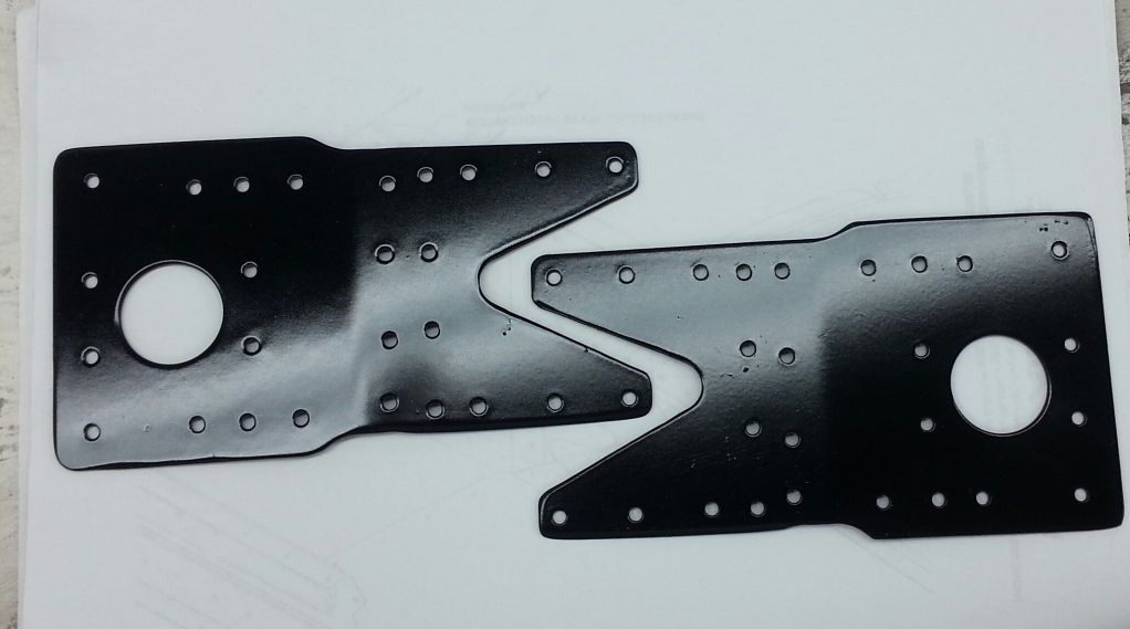

Im in the process also, got all the rivets out today, and got the pieces separated and edges polished, cut the angles and bent them to 86.9 degrees...
Still wounder why some of the rivet spacing could not have been the same on the angles.
But regardless, did all the measurements drilled the holes and tomorrow if all goes well will prime all the new pieces and Saturday put it together.
I am glad to say I got all the rivets out without drilling through any of the metal.
The spring loaded center punch as mentioned before worked like a champ and a backing bucking bar did the trick.

Originally Posted by Smilin' Jack View Post
Bret,
Jack
Here is how my spacing came out.
