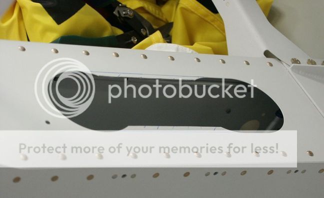

May not be a consideration in your case, but the base on my Jigsaw was about 2 3/8" wide. Which would have left a lot of filing, or creeping up with the snips anyway. (The final cut line was less than an inch from the rivet heads)
Don't know about the quicker/best method, but it was easy, safe, and left very little swarf/mess with the snips.
Paul.
(Before final cuts.)
