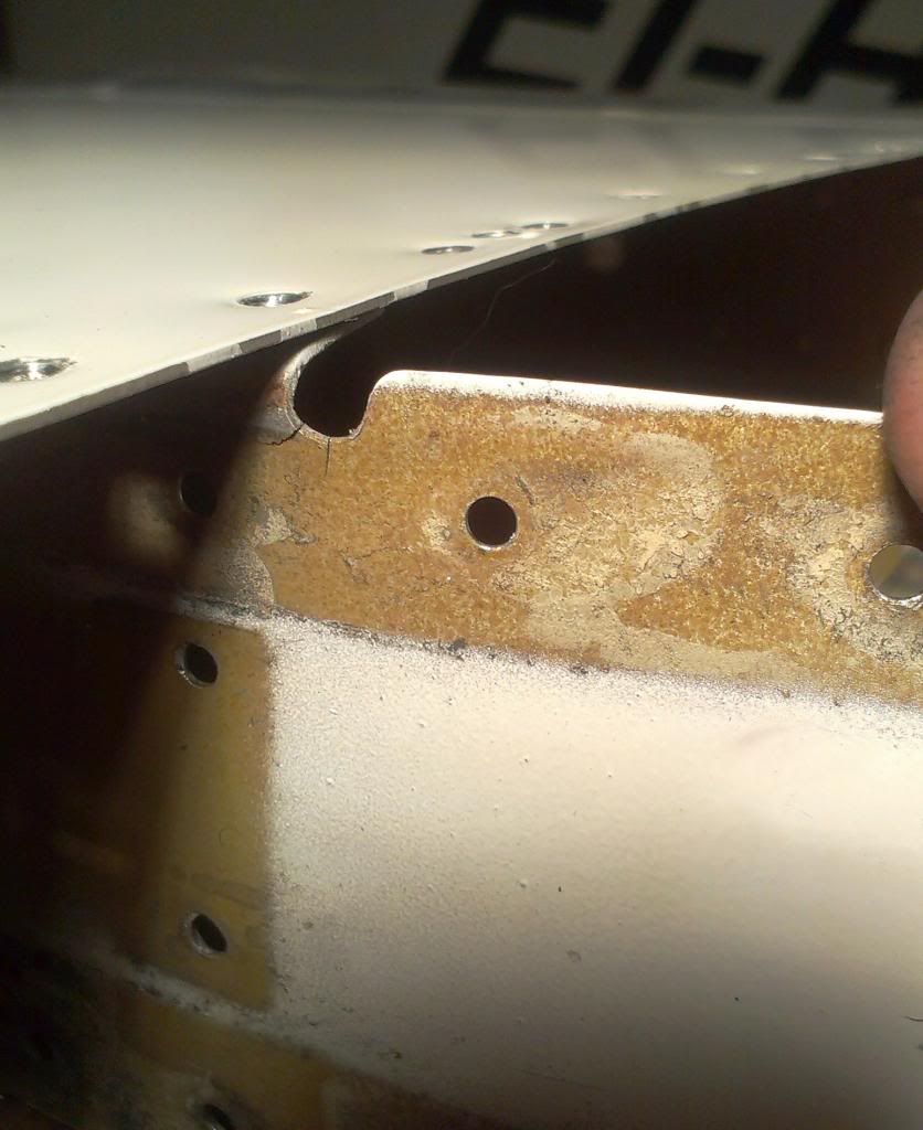

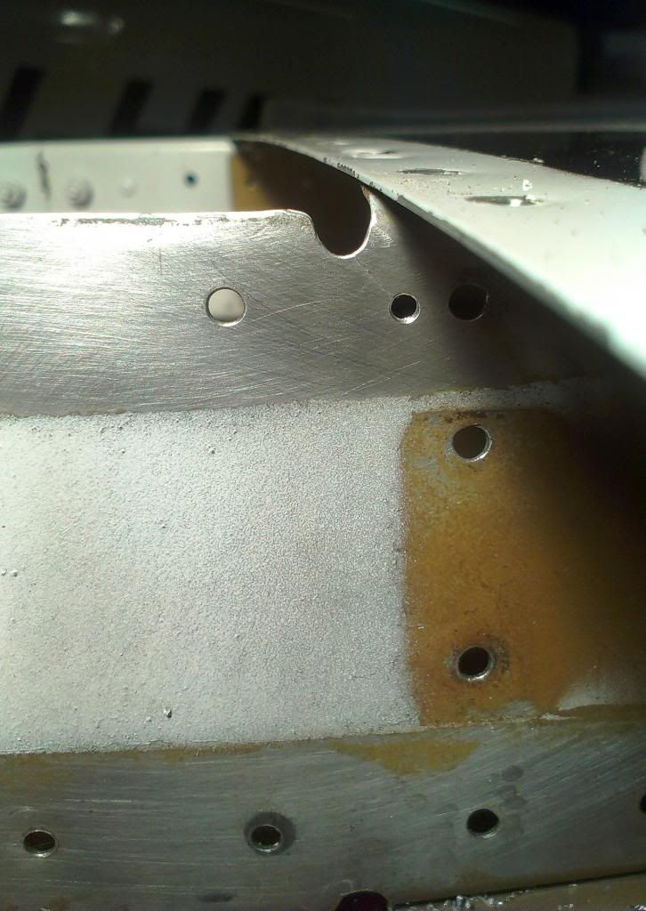

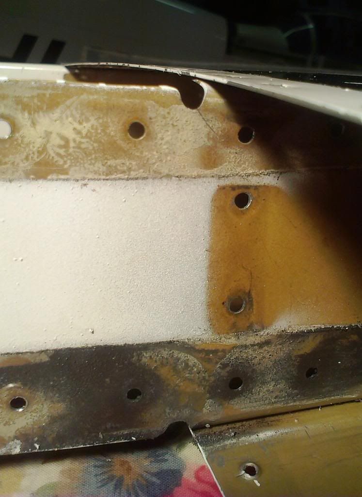

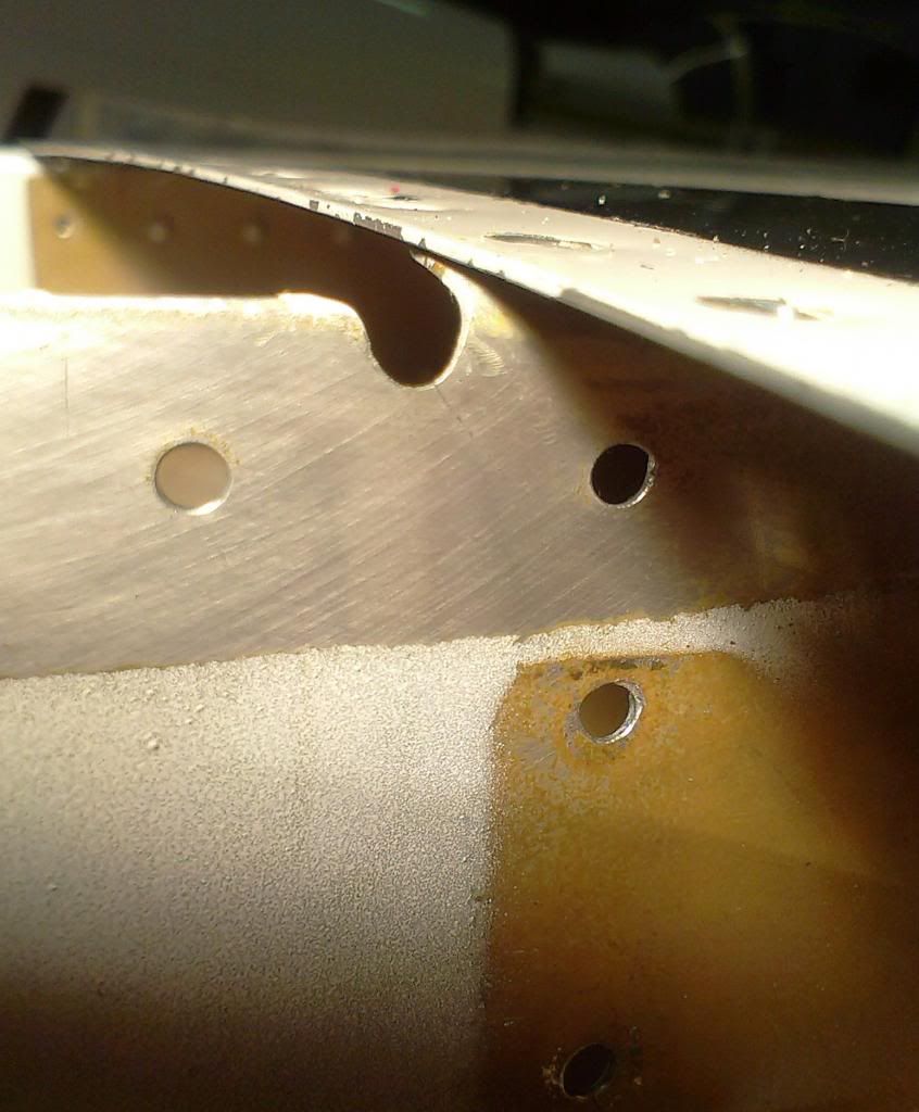

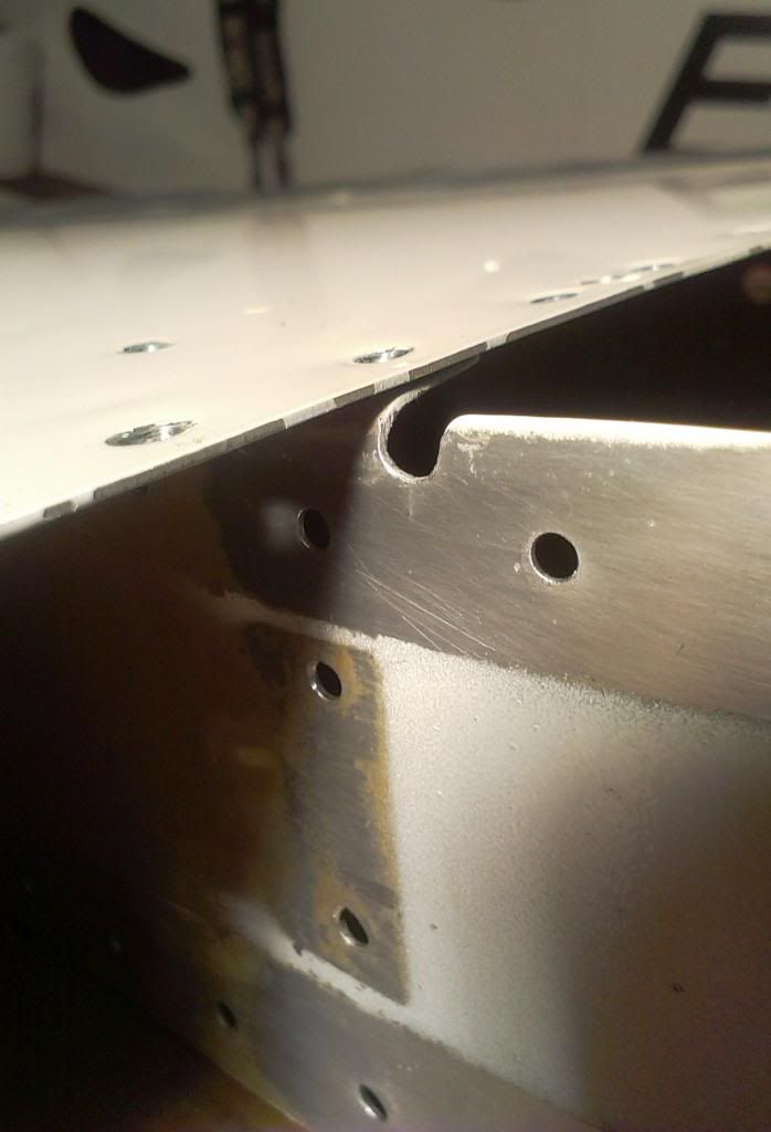

Default Pics of Cracks EI HUM
Port Crack 'raw' as seen once disassembled:
Port crack clean:
Port crack stopped:
Stbd - 2 cracks here, hard to see:
Stbd cracks 'stressed' - easy to see now:
Stbd 2 cracks clean:

Are two holes that close together in a place where cracking is prone a good idea?
I would be seeking clarification on this from Vans, and be ready to build a new HS.
