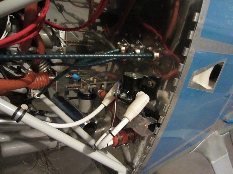

I also have an AeroSport I0375 with Superior forward facing cold air induction & Hartzell rear mounted governor.
Got one 60" & two 55" cables with my firewall forward kit from Vans. Used the 60" for the throttle, returned the two 55" and replaced them with custom lengths - 52" for mixture & 46" for governor.
Here's a picture of how they came thru the firewall.
[IMG]http://[/IMG]

Mine were in this order
60 throttle
55 mixture
52.5 Gov...
the lengths Dennis gave would have worked too. Mine were a bit long but managable.
