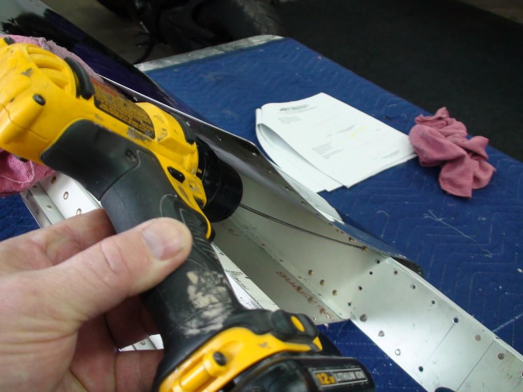

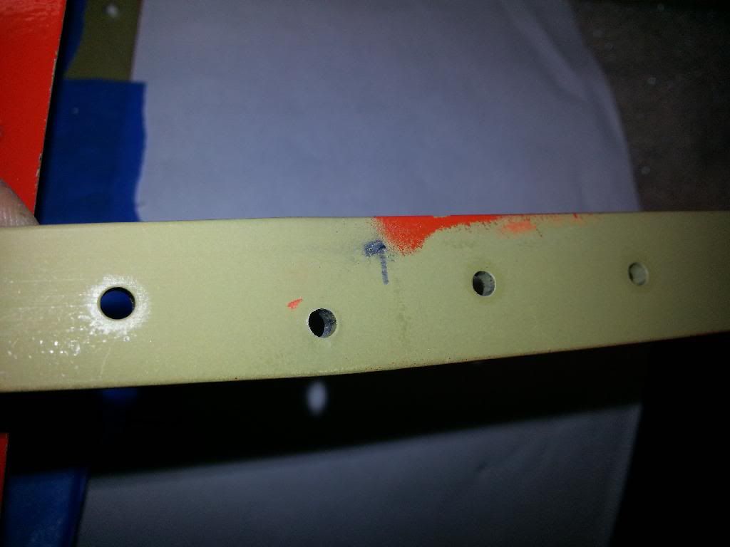

When I removed the top angle I was surprised to see fretting.
See photos below. The metal was flexing a good bit to cause this.
Its not deep and can be cleaned up with Scotch Brite.
I checked the botttom, both sides with dye penetrant and no cracks on the bottom.
In the photo the elevator is turned upside down.
I've cut two of the spar flanges back at an angle so far.
Surprisingly, this may be the most difficult part of the SB.
Mark

I finished taking mine apart this morning, if you really look at it, this mod is going to add a great deal of strength to the forward spar. I can see where the flimsy sheet metal spar could flex easily during non SAL flight, stalls, spins ect.

I wanted a little more room so this is how I did mine.

Thank you for the pictures and post! It is very much appreciated!
