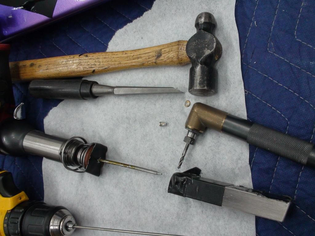

Originally Posted by ILikePike View Post
Pictures Bret?
well, kinda getto, but it worked.
  #472
Old 02-08-2014, 06:26 PM
bret's Avatar
bret bret is offline
Join Date: Feb 2010
Location: Gardnerville Nv.
Posts: 2,828
So if you did the HS like me, the manifactured heads are facing rear, and HS 405 is installed so that it is dificult to drill, I had to bend the 12inch 40 drill while drilling to get a straight shot in the MH of the rivet. These are the tools I used. Kinda back yardish but it worked.
