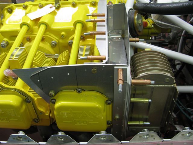

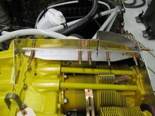

For whatever it's worth, here's what I did evolving from other posts on this forum. So far only 6 hours, but if this sucker cracks I'll be surprised.
Hardware store aluminum angle stiffener:
1/8 sheet to spread the load, note the aluminum angle stiffener bolts to it at the outboard end:
Additional .040 doubler:
No photo unfortunately, but oil cooler attached with 6 thru bolts with sleeves between the flanges.

Just completed the repair on my cracked cooler mount. Standard Van's baffle installation. I only have 57 hours, and removed cowl for general inspection. Probably wouldn't have even looked at the cooler mount except that I caught this posting last week. There were hairline cracks above and below both platenuts on outboard side. I definitely don't think it would have gone another 50 hours.
Did pretty much what others have done with a 1/8" reinf. angle, 1/8" doubler under the existing stiffner angle on top portion of cyl. 4 baffle tied into the forward baffle screw, and brace to inboard side of cooler from backside of center rocker cover screw. I now have a new attach point to lift the engine. The whole fix took about 25 hours over several days. Done with the original baffle construction could have done it in a couple of hours with scrap materials from the kit.
