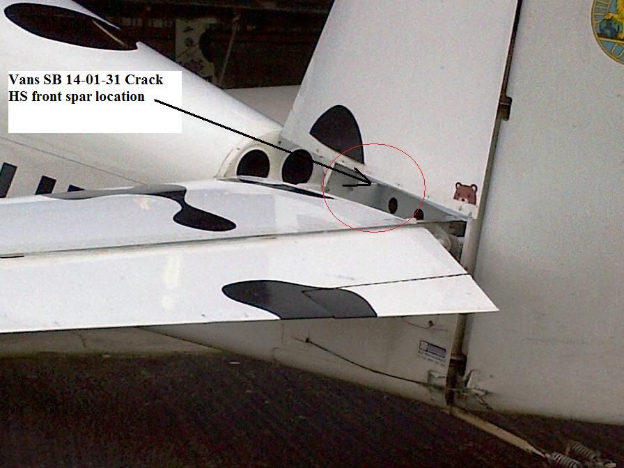

My RV7 EI HUM Serial 70588-1 has approx 850 hours since I built it, lives on a grass strip and does a lot of aerobatics. O-320, sensenics Fixed Pitch Prop.

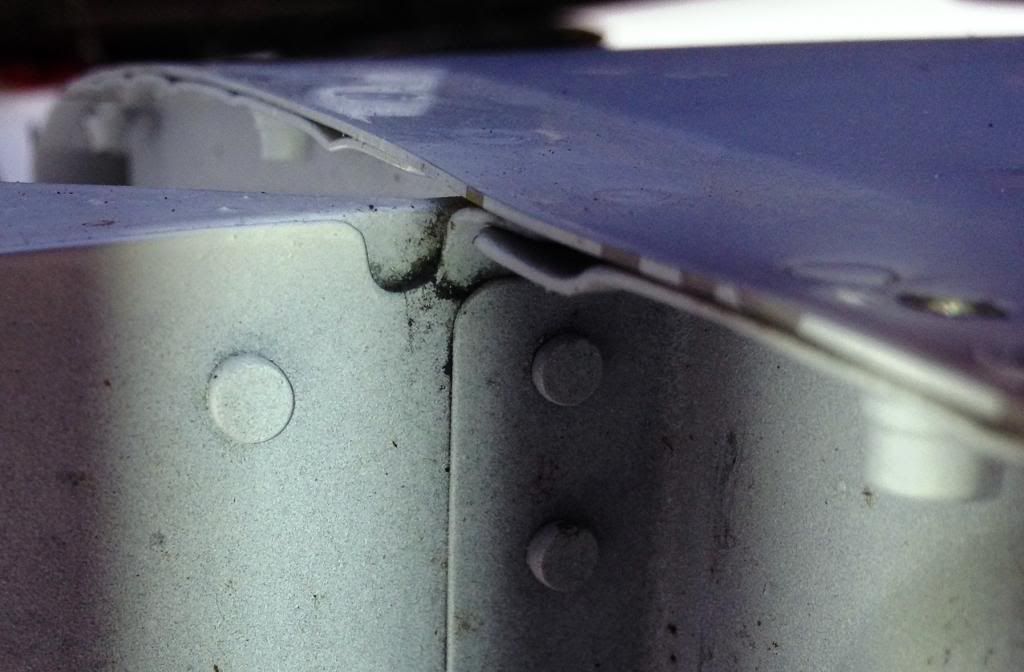

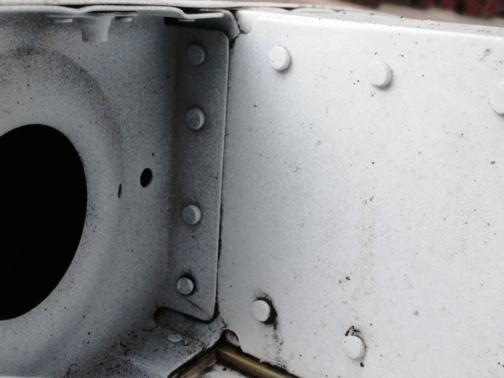

I found cracks both sides, possibly 2 x cracks on the Stbd side.
General view for those who have not yet studied this:
At least 1 x Crack on Stbd side (will examine closer & report back when it comes off):
Another crack port side:

Default Great pix Hum!
Hum, thanks for the great pictures, including the wide shot to help with orientation.
Could your port side also have a crack at the bottom?
Carl
