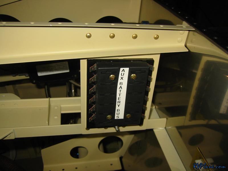

Hi Simon,
This is where I placed my fuse blocks:
Battery and Main Bus fuse blocks. Attached to the F-745-R Forward Fuselage Rib, facing outboard.
E-Bus and Avionics Bus fuse blocks. These are mounted back-to-back with the battery and main bus fuse blocks. Attached to the F-745-R Forward Fuselage Rib, facing inboard.
Auxiliary Battery Bus fuse block. The upper attachment point is to the F-643-1 Fwd Fuselage Channel facing right. The lower attachment point is to some angle I installed running between the firewall and the subpanel, which I used to mount an auxiliary battery in.

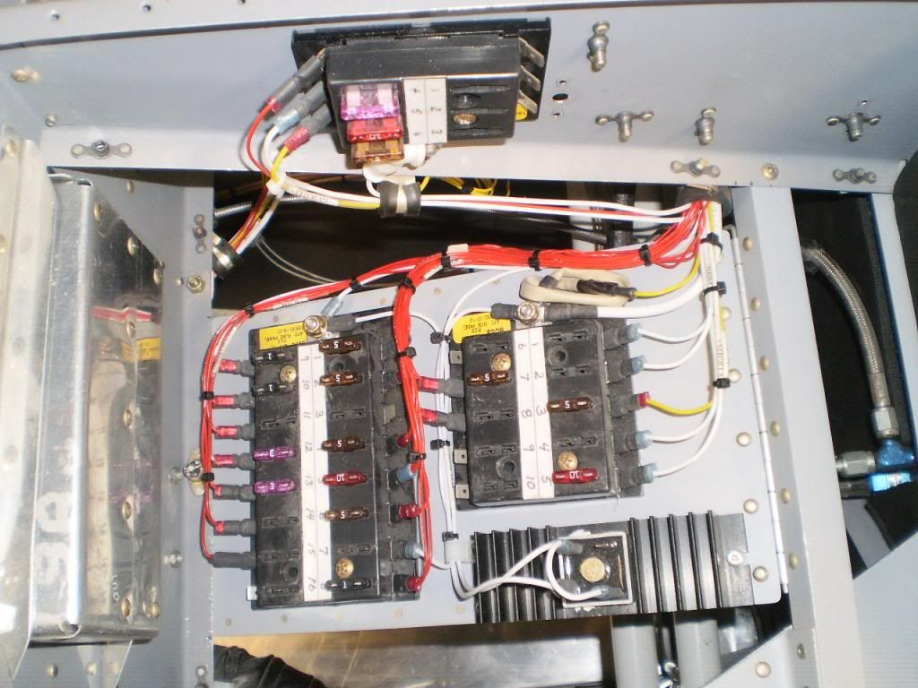

This location worked well for me. Ideally it would all be moved aft (towards the panel) but I liked the idea of the glove box and squeezing in the fuse blocks under the glove box would have been a challenge. This is not accessible in flight but not much of an issue when parked. I have c/b's for alternator field and Lightspeed ignition. Everything else is on the fuse blocks. (For orientation, fuse blocks are over right rudder pedels, firewall to right in pics.)
You could have taken those pictures of my installation - I did something very similar (except I used all fuses) and it's worked out great for the ~200 hours or so I've been flying it.
