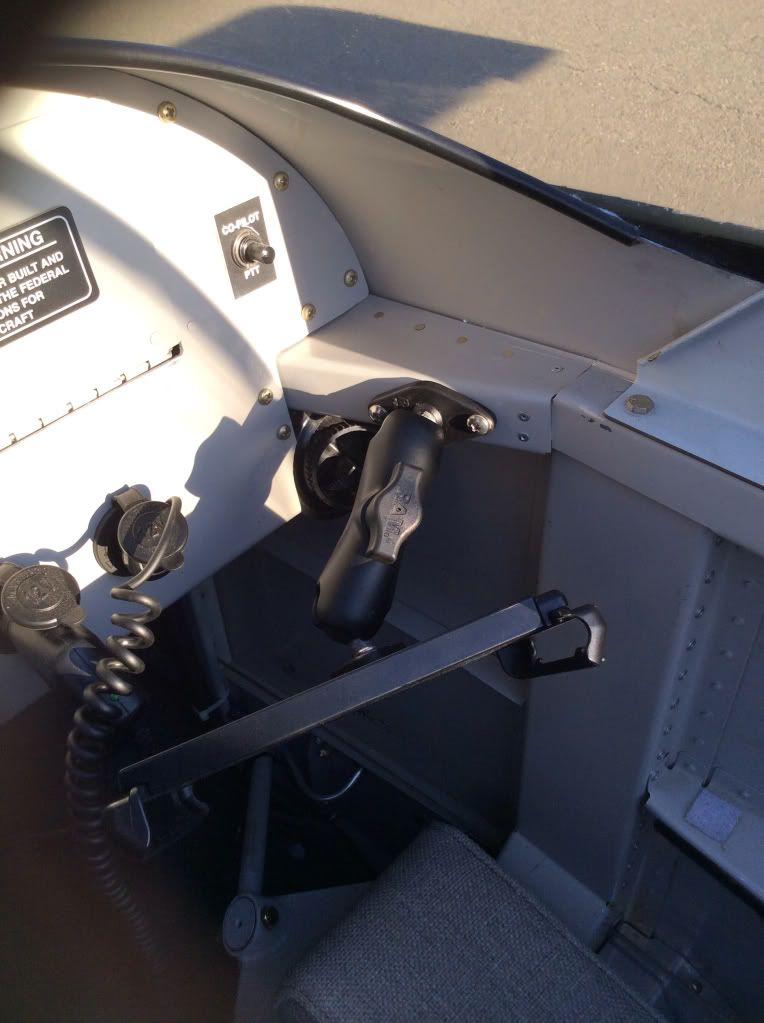

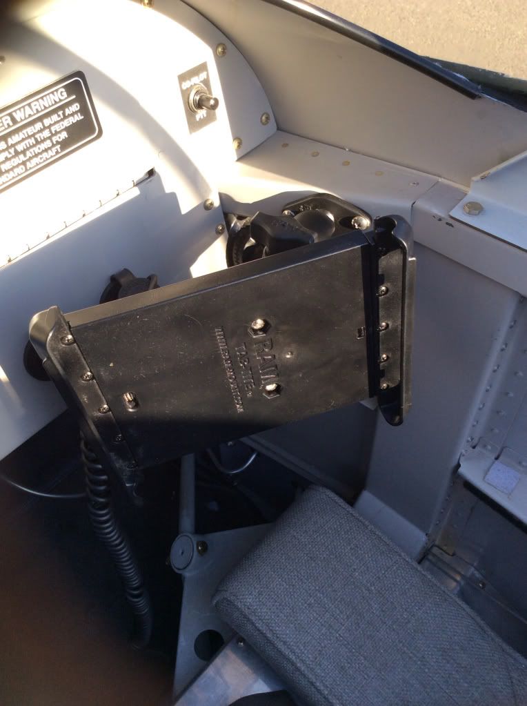

I finally settled on mounting the ball base to the F721A-R, FWD Canopy Deck:
I used the Univeral Cradle (RAM-HOL-TAB12U), two diamond bases (RAM-B-238), and a double socket arm (RAM-B-201U).
I had to use a Dremmel to open up the cradle a bit to clear the music output jack and to clear the ON button at the top of the iPad.
I attached the base to the canopy deck using Rivnuts.
I do have to rotate the Mini out of the way of the map box to put my checklist back in it but I usually don't need to open it in flight.

Default Here are some better pictures of my setup
I finally took some better pictures of my setup over the weekend:
