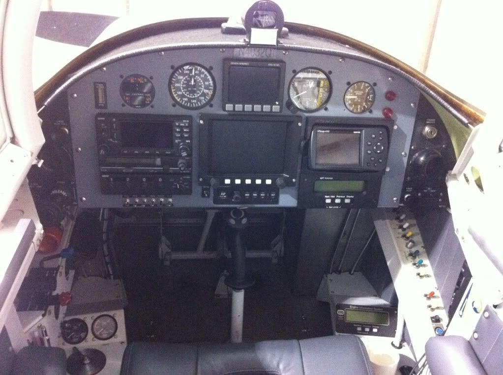

I used both in my 8a, if you look at the lower right panel the EIS fits perfect.

Wow! Thanks, everyone, for the great (and, as expected, often conflicting) advice!
I really, really, REALLY like the remote radio tuning via Android app from the back seat. When we bought our plane, we had the back cockpit outfitted with throttle and rudder pedals, so that we wouldn't feel totally helpless (I've actually landed our -8A from the back cockpit) -- but without a way to tune the radio, we would be screwed if the front-seater became incapacitated in controlled airspace.
I really, REALLY like the idea of being able to stash my EIS behind the panel, connect one wire, and have a modern engine monitor display. Several people have recommended that I do that as a "half step" and simply add that display (called the "Sport", I think?), a new digital transponder, a second PS Engineering com radio (the one with built-in audio panel, so I could keep my other com), and call it a day.
Obviously that would save us huge bucks over replacing everything.
We still would end up hating the GNC-300XL GPS, though. I could live with that, but listening to Mary complain about it on every flight is starting to wear me down.
Jeez. Nothing like too many options. "Analysis paralysis" is setting in!
