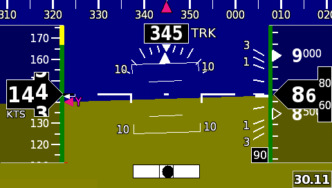

AOA is being explored as an option, but I don't have any details about availability or features yet.
Here's a screenshot off the Mini-B (no synthetic vision):

Unit looks great. Just have a few more questions about the Mini-X.
1. What drives the heading bug? Manually set to a heading or can input from external handheld GPS flight plan drive it?
2. What do you mean by stand alone GPS Navigator?
3. Can you flip/flop display between indicated air speed, true airspeed and GPS ground speed or will it show all three at same time?
4. By limited Auto-Pilot do you mean it will only control pitch and roll and no altitude change?
5. Nice offer to initially include the Magnetometer with the Mini-X. Any chance offering OAT probe and battery as an alternative to the Magnetometer? Do I need a Magnetometer if I have a compass?

Hi Guys-- Sorry it took so long to respond to these, I had to double check some facts!
You can do both if you have the external magnetometer option. On the Mini-X, you can use the knob to set the heading bug if you have the magnetometer. Either way, you'll be able to track either the internal or an external GPS flight plan or direct-to.
2. What do you mean by stand alone GPS Navigator? You will be able to enter and track a GPS flight plan using the Mini's own internal GPS, showing a GPS CDI needle, and time/distance/bearing to waypoint.
3. Can you flip/flop display between indicated air speed, true airspeed and GPS ground speed or will it show all three at same time? You'll be able to configure data boxes on the PFD screen to display TAS and groundspeed as supplemental information near the airspeed tape.
4. By limited Auto-Pilot do you mean it will only control pitch and roll and no altitude change? Yes. The Mini-X will have Heading mode (with magnetometer), ENAV (GPS tracking), and Altitude Hold. It will also track a VOR/LOC signal if you have a serial nav receiver connected to it, such as an SL30.
5. Nice offer to initially include the Magnetometer with the Mini-X. Any chance offering OAT probe and battery as an alternative to the Magnetometer? Do I need a Magnetometer if I have a compass? You won't need a magnetometer, but it will add some good functionality to the Mini because it will give you use of the heading bug, and actual heading will be displayed instead of GPS track. To keep it simple I'll say no substitutions, but if you call and talk to Todd, who knows what he'll tell you.
