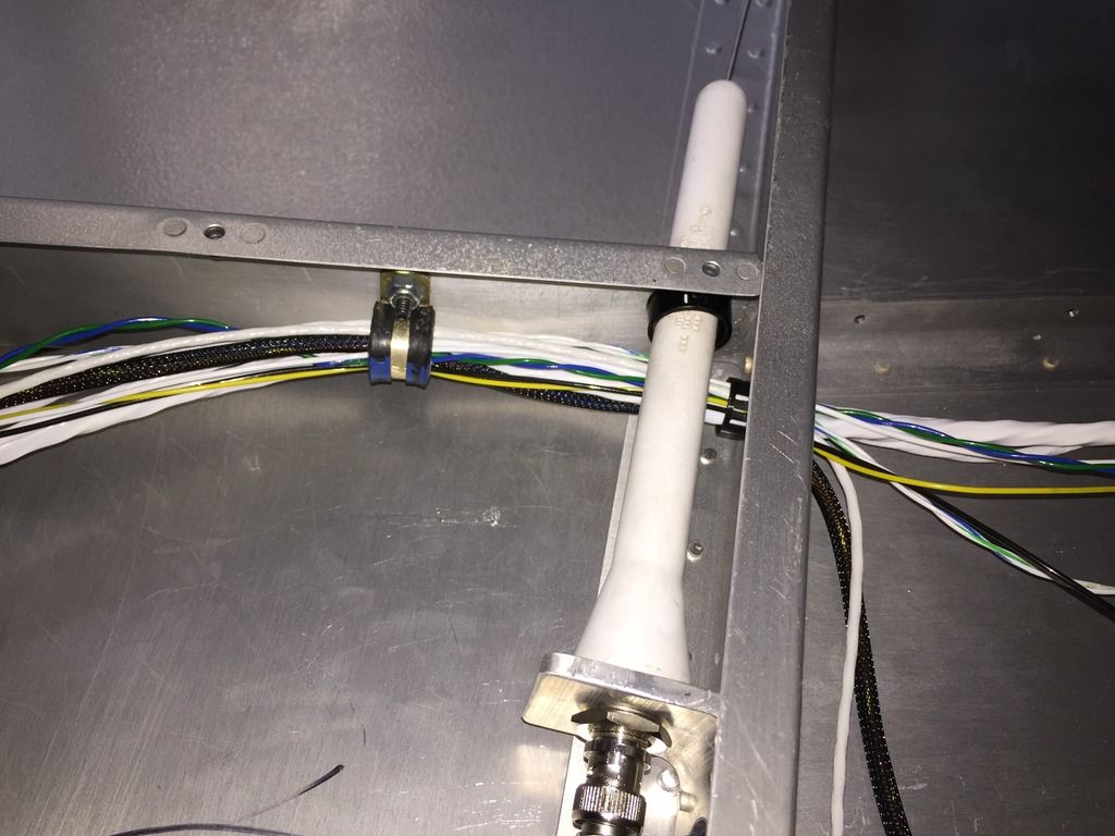

My new Kannad Integra is giving me an external antenna fault. Could anyone comment on whether the problem might be where my antenna is mounted? This photo is from the rear seat, looking up, under the rear, right armrest. The whip portion of the antenna is slightly curled around the turtledeck with a couple of small adels to prevent interference with the canopy.

You simply cannot mount the antenna like this. You have created a coupling to ground at the high current part of the antenna (the part near the base).
Mount it horizontally under the empennage fairing. Ignore the "it must be vertical" noise as if you really need the ELT to work it may well end up vertical.

Default I'd like to but...
the newer 406 ELT antennas are too long to mount in the tail, like everyone used to do.
I must ask, though, why isn't my mounting essentially the same as mounting it on the outside fuselage skin?

The install manual gives you pretty good instructions on mounting the antenna, bottom line is without a proper ground plane the antenna will not function correctly.
(try mounting your com antenna like that and see how good it works)
My ACK 406 ELT antenna fits fine under the empennage fairing.
Your mounting is a close couple to the fuselage. The empennage also presents this issue, but the spacing is much wider than your 1/4" or so. Think cube function for this type of interaction.
Bottom line is any antenna is better than no antenna. I like the empennage area as the intersection between th VS and HS seems to be the most survivable location for the ELT antenna.
