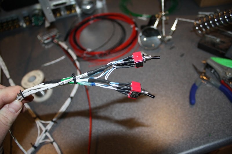

Mark,
I have tried to get good meaningful under and behind pics and have never been able to get good ones. Even with a wide angle lens, it is so tight back there that it is hard to get enough context out of em and good focus.
Keep in mind that my panel was a third generation retrofit and that it was done in a finished airplane without very good access. The power distribution was also replaced with a VP-X Pro so that even made it more of a challenge. That being said, I had to make some compromises in order to make it happen. The wire routings and logical order may not be optimized due to constraints or lack of access. If I were doing the same panel in an unfinished plane without the front top skin in place, the work and arraignment would be much different.
Since I built my avionics harness on the kitchen table and laced it all up before install, most of my bundles that cross the subpanel just route under it with a clamp on the bottom flange of the subpanel.
As far as power wires and signal wires, in these airplanes, it is difficult to keep em completely separate. Do the best you can and hope for the best. Garmin's use of all shielded cable helps a ton to prevent issues. Follow their directions to the best of your ability when it comes to shields, shield drains and grounding and you will be fine....

Worked on the TT GX Pilot and TT Gemini PFD harnesses today.
These Track Source switches add complexity to the situation and I am not sure they are worth it or not. While they do add some redundancy, 99% of the time they will be in the EFIS position.
Christer at SteinAir told me that they don't put these in as many panels these days...
