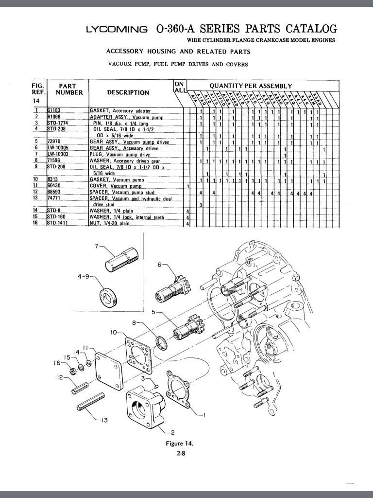

On that note Lycoming parts manual has two different drive gears listed for that accessory pad one for with accessory and one for vacuum anyone know if vacuum type needs to be changed out to fit alternator there?

My O-320 E2D began its life on a Skyhawk with a vacuum pump. There was no modification/change required to the drive gear for the B&C SD-20 drive to fit perfectly.
I suspect your engine will be the same.

This is what confused me difference between part 5 and part 6
