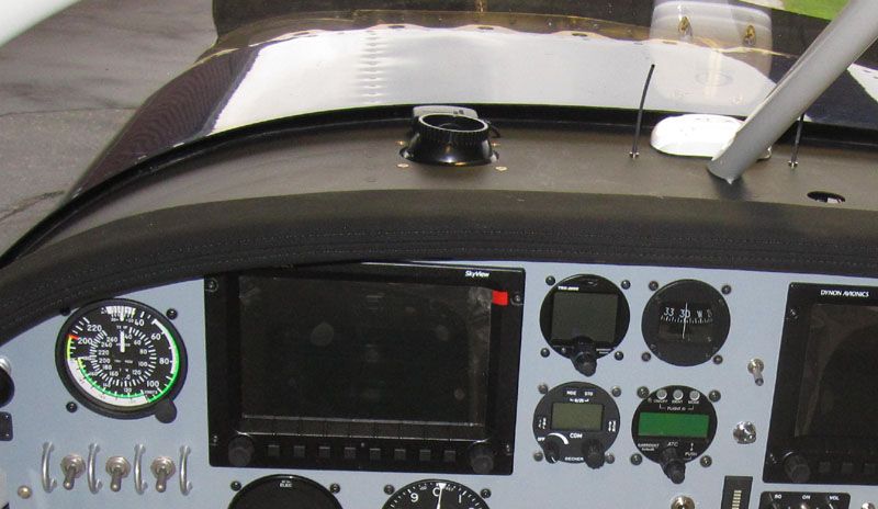

First plane (7a slider) just cut 1/2 x 5" openings above avionics letting their warm air rise thru to the w/shield. Worked great except on real cold days where w/shield would fog up in the corners when first taxiing, but clear when flying.
Next plane (7 tip up) used complicated ducting & fan from heater & required connectors between airframe & tip up. Fear that a concentrated hot spot may damage the w/shield drove us to restrict/reduce airflow 90% and gave satisfactory performance.
Since then I've resorted to using a simple computer fan, square duct/fan mount, below a slot cut in the glare shield. Excellent results.

I mounted 2 small computer fans in my RV9A tip-up. They are controlled by a single switch. I've used them twice so far. Both times it was morning and my tip-up started to fog up. Turn on the fans and the moving air clears up the canopy. Works great. I'll try and get some pictures tomorrow if I go out to the airport.
