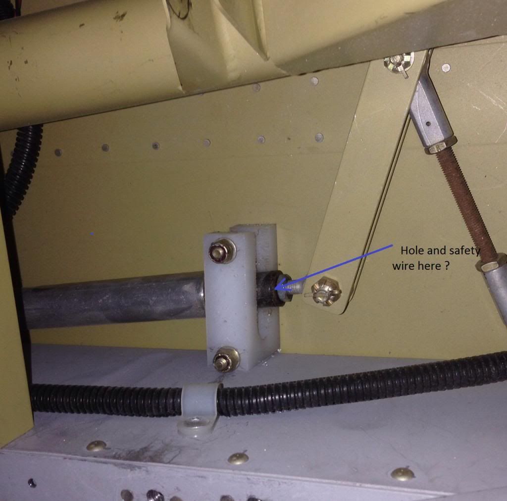

Would someone have a picture of how the Vans flap screw jack Service Bulletin has been done?
Aparently the process is to drill a hole through the washer ( see picture Ive attached) I'd just like to have this operation confirmed before I start drilling.
http://s1118.photobucket.com/user/De...99817.jpg.html

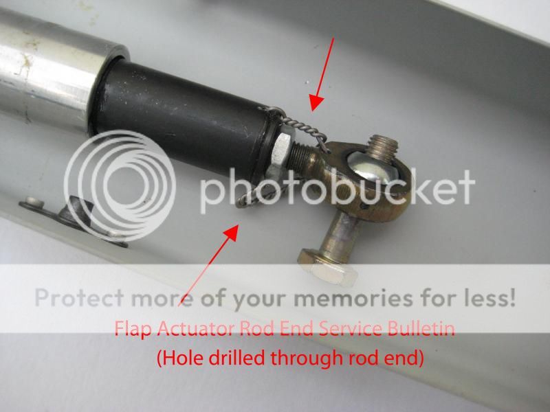

Derek,
Yes, drill a hole through the end of the actuator as shown. Obviously you have to allow some clearance for the stop nut and also be careful to drill at the correct angle to clear the edge. Also, there seems to be a lot of consensus on this list that a better way to loop the safety wire is to drill a hole through the rod end as shown. This is on an RV-6 but should be the same for the -4.

[quote=Pat Hatch;823750]Derek,
Thanks Pat,
Appreciate the quick reply and picture. Perfect !

I did the service bulletin, but i also used a piece of .032, drilled a hole for the rod end bolt and worm clamped it to the shaft of the actuator so there is no rotation as the actuator extends an retracts. That way, the jam nut and safety wire are just backup.
