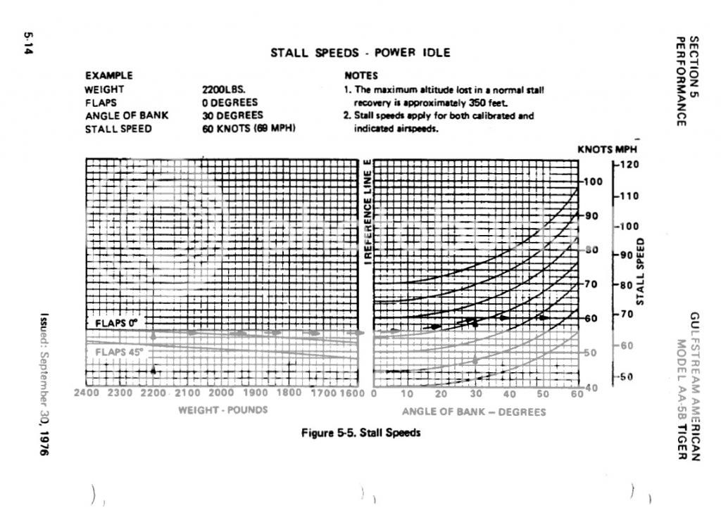

The same data as above for a constant altitude banked turn stall speed.
It may be easier to see in graphical form in the right hand chart -
Gil Alexander
