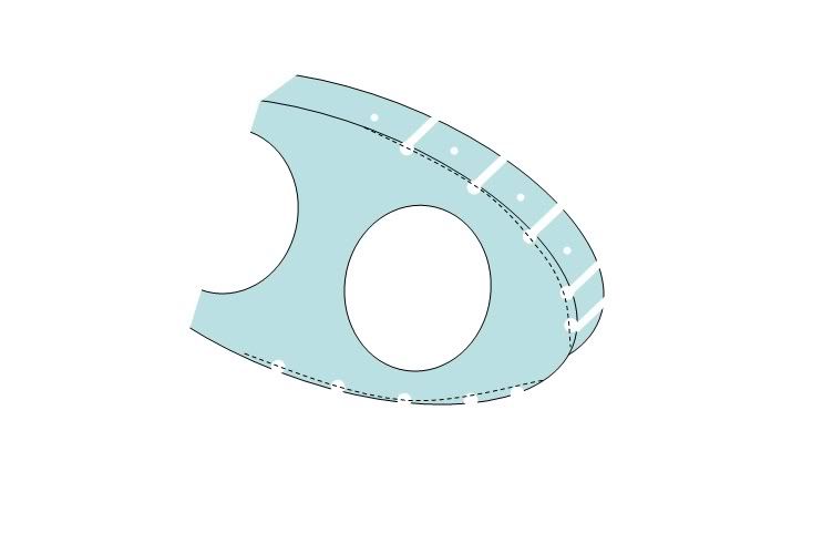

I had a very difficult time making the nose ribs fit. Using the techniques described here by others I was able to wrestle them into place. When I was don I had a completely unacceptable wavy leading edge. Talking to Vans, then recommended I re-shape the nose ribs to improve the fit. The last thing you want to be doing when you have proseal on everything is struggling to get things in place.
This is an illustration of what I had to do with a hammer and pliers. It's a little exaggerated for illustration purposes, but not much. The dotted line shows the new profile. Go easy and take your time - adjust a little at time.
