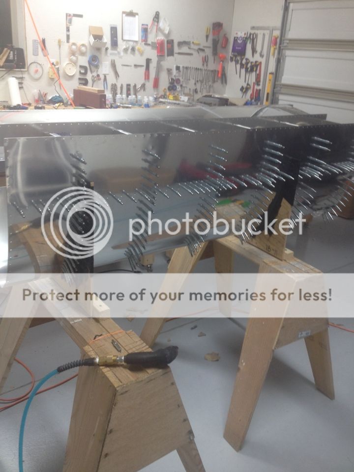

Anyone else using cheap wooden saw horses to build leading edge. It makes it easy to move around rivet holes, since both can move.

I just used a regular card table.

Nice setup!
You have a good point on movind around the assembly right at hip height.
Right now, my setup lies on the ground because my table and workspace are all crowded. Specially because I'm working on both wings at the same time, which takes up more space because the tools and construction materials are always off the shelf
Thanks for sharing this

That exactly what I've been using on both projects. I just move them to another bay if the brackets are in the way for riveting.

My benches are EAA benches that are 6' long (I think that EAA benches are 5'). I currently have them screwed together. The benches are long enough to fit the spar completely on the bench with an extra foot or so in length. The standard EAA benches would leave the spar hanging off the edges a bit (I think) I also put a 1.5" lip all the way around. Very useful for clamping. I clamp stuff to it all the time. I also put a piece of sanded plywood on top, which is very smooth.
I also put wheels on the tables. I don't move them a lot, but it is useful. I can post more pictures if you are interested.

Yep, that's the same thing I did. Cheap saw horses and instant mobility at a height I can live with.
The so called "standard" EAA bench is 5 feet long. I built two of em. They are OK so far, but I may need at least one more for the fusalage. (Wood being what it is now adays, the first two came in at almost exactly $100.)
