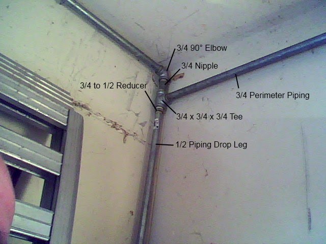

Here's one way to do it. It's been working just fine for several years. I currently have two medium 110v compressors on the system which gives me about 14cfm which has been plenty for painting. More details on my blog page.
http://larrys-airplane.blogspot.com/...d-for-air.html
