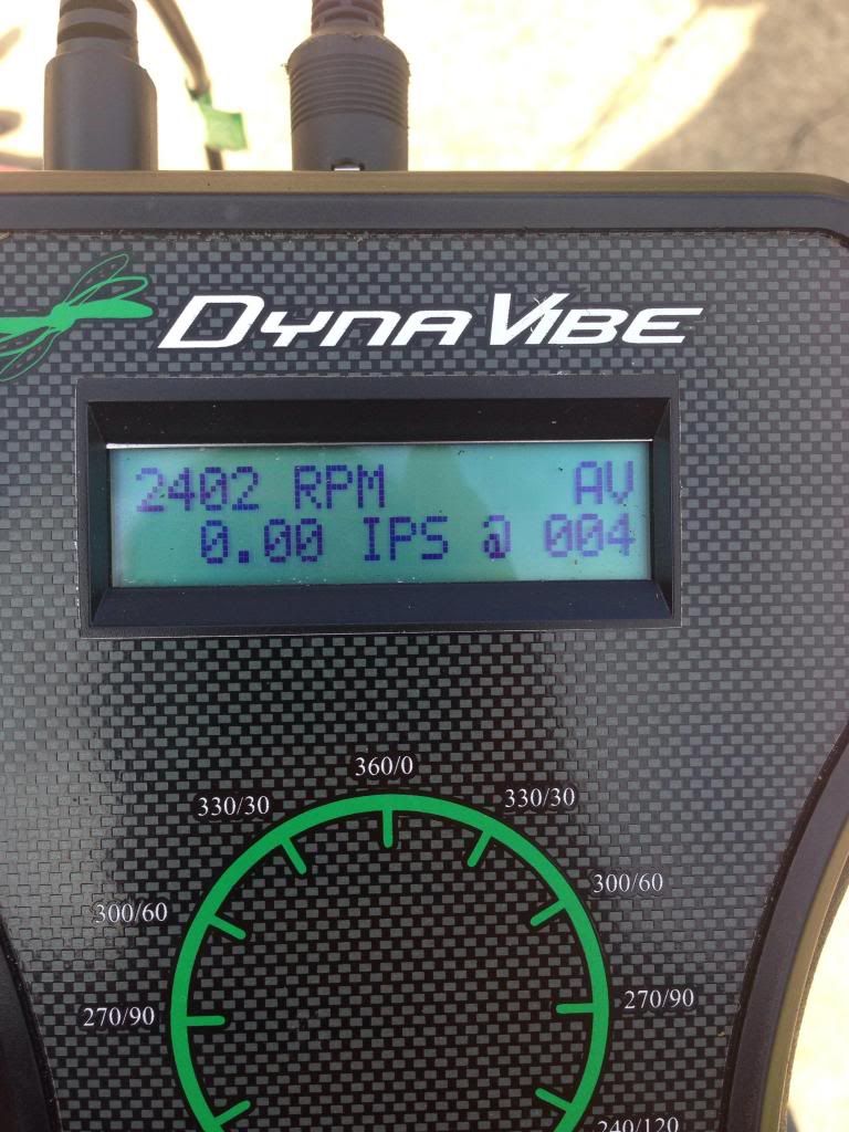

How many have had their -10's dynamically balanced? What was your beginning and ending numbers (ips)? I just balanced my first -10, which had been balanced before, and it took 6 runs to get from 0.263 down to 0.030.

Just did a balance on my Super Decathlon after a prop rebuild. Balanced it at 2500 as that is where I usually run when flopping around the sky.
Got it to .01.
First run said add 24 grams - drilled the back-plate and added washers and a nut and bolt. Second run said add 5 grams- large washer under a spinner screw. Third run we were down to .04, needed a wee bit at 9:00 - added a small washer under another of the spinner bolts. Fourth run said we were .01 - leave it alone!
Runs smooooth.
That's why in 99% of the cases I install weights at 2 seperate locations on the back plate or flywheel, that gives you the ability to tweak the polar location and weight. Leaving various washers under spinner bolts works but it is not a good practice or an "approved" procedure (the next time you or your A&P take the spinner off it may not go back on the the same way).

Walt knows what he 's talking about. I see anywhere from .2 to .5 on a regular basis prior to adding weights. Sometimes you get lucky and only need weight in one location. After years of balancing props, I've only managed to get 0.00 about 3 times. In theory you should not be able to feel 0.07. Feel free to call or PM if you have any questions.
