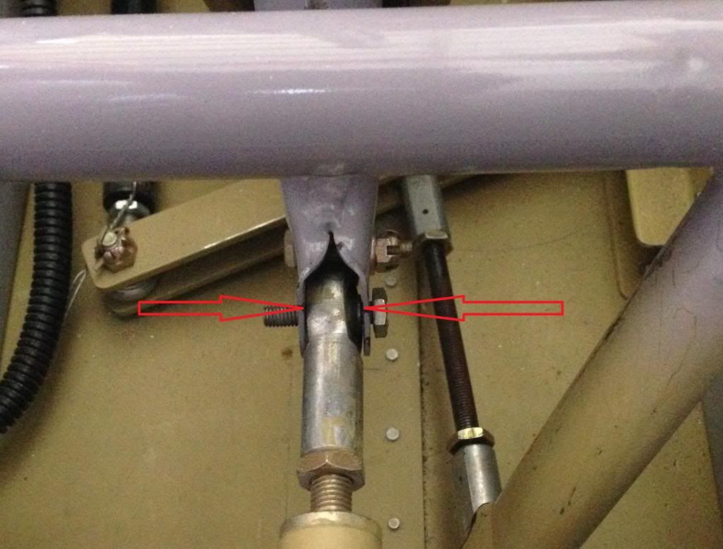

Im currently connecting up my elevator control tubes ( pushrods). The plans call for 2 washers to be installed, 1 each side of the heim joint ( see picture attached). The fitting that the heim joint slides into doesnt have enough spacing for one washer, let alone one each side as the plan indicates.
Im assuming that I have to expand (force) the fitting open enough to allow those 2 small / thick washers to be installed ? If the washers are 60 thou each thick, this means I have to expand the fitting by almost 1/8". Sounds butcherous.

on my -4 i had to use some ''persuation'' to get those washer. one fit easily but his friend need some expansion. on your picture above the arrow, it seems like a break in the weld? may be my eyes are playing trick on me.
on the plan, it should provide some dimension.
good luck

Hi,
Thanks for your reply, I'll check the plans as you suggest.
Im assuming that my only option will be to expand the fitting, Ill post another photo once im done.
