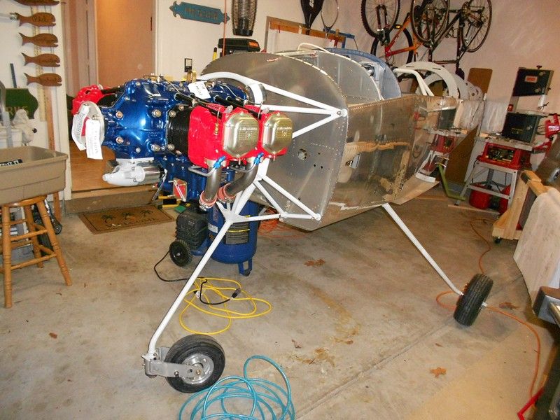

Yesterday was a momentous day in the build. I hit two major milestones ... all in the same day.
With major back surgery just under three weeks ago, I am limited on the weight I can lift so I enlisted some helpers (the usual suspects) and borrowed an engine lift from the flight school where I instruct and got down to it.
Yes, I had helpers ... but there was no shortage of "supervision".
The gear legs required some silicone spray, muscle, lots of PATIENCE and a little bit of creativity - I ended up destroying an old long drill bit extension by grinding it down to make a guide bit/awl to help "influence" the legs into final position prior to dropping the bolt in place. The left side required a little extra influencing but we made it.
So around 1630 on 14 Apr 2013, N-251WM stood on her legs and walked for the first time! I have to say it is MUCH easier to push the aircraft around (even with the engine hung) on the wheels vs. the cradle.
Then down to business unpacking the engine. Let's just say there was foam EVERYWHERE.
Onto the lift, a quick check to understand how it all fit together and forward to the mount.
Again, a little bit of ingenuity (okay, one of the guys hanging on a rope wrapped around one of the bottom Lord bolts to move it into place) and the engine was hung around 1830.
A happy day. So she is tucked away in the garage now and ready for the big move this summer ... wherever that might be.
