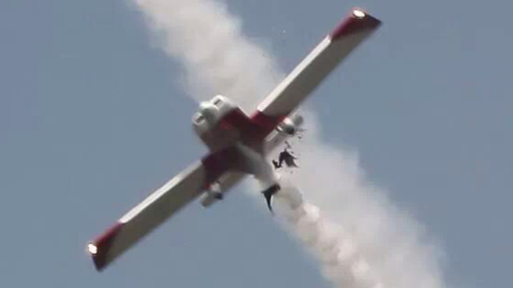

Default Not the Lone Ranger
here.
While performing at an airshow a few weeks ago, a Turkey Vulture went THRU my prop arc unscathed, but he was not as lucky when he encountered #4 in the slot. The Turkey Vulture was chopped in half and folks on the ground said it sounded like a shotgun blast. The only visible damage was scratched paint on the prop. Number 4 did not have a hunting license is keeping a low profile.

Default Impressive photo!
Originally Posted by billgill View Post
All I can say it wow! And, I'm glad all people and planes involved came through with nothing more than a prop strike!
