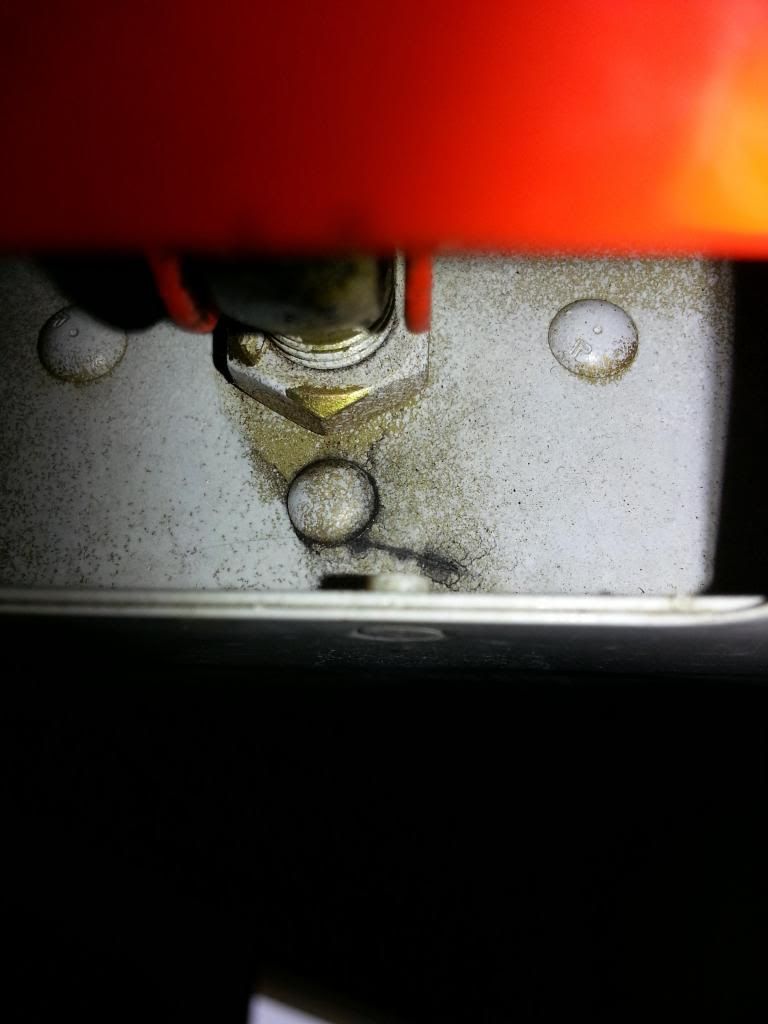

Due to the recent loss of a VAF'er I decided to inspect my empennage very carefully.
I found a crack in the right elevator spar at the outboard attach point.
This is how it looked upon inspection. Just a black line.
I wiped the black off the left side but you can still see the crack below.
And here it is after the dye penetrant test.
It's an RV7A serial number 72183 with 908 hours.
Everyone please check your elevators carefully before your next flight!

A loose jam nut could be the cause of such a crack, if the jam nut is loose the nutplate and nutplate rivets are carrying the full load of the fitting.
FYI - I find loose jam nuts on elevators and rudders routinely
PS: good find, everyone should inspect this area at the earliest opportunity.

Assuming the rod end was tight, and the elev hinge line along the H stab rt side is razor straight, as is the elev hinge line, I would suspect a vibration mode of some sort here (elev counterweight involved) - I doubt you could do that with any sort of flying you would do in that plane - well - maybe 10 tail slides per day since the first flight? You're not doing that, are you?
I suspect a hinge line SNAFU, with the area of least strength (outboard hinge/smallest spar cross section)) giving up 1st. Get your dental floss and string-line bushings back out!
Could be that rivet was not driven correctly - the markings show it is a hard rivet...so that's not likely to be it.

Mark: Good Job for paying attention and being proactive. No way to tell how long your crack has been there but looks like a few hours. This is a good illustration of how the parts of our "airworthiness system" work together. The airplane structure is designed to be tolerant of some level of damage or defect like this spar crack for a peroid of time until the inspection process comes around to catch it. Please keep us posted on what you find and how you resolve it.

My Cessna 120 had an AD to look for such a crack , along with the Rudder on an A36 Beech Bonanza , and the horizontal on a Rockwell 112 . I do believe the fix was either doublers or spar replacement .
As inexpensive as Vans parts go , I might opt to build a new one . A complete tail kit cost about the same as the cost to inspect the A36 or the Rockwell .
After the latest inflight breakup and another post about the length of rudder rod bearings we all need to take a realy good look at the tail components .
Remember tail kits are place that most every one learns on , most with NO construction experiance .

Mark, thanks for the post. I checked a friends RV-7 and found all 4 jam nuts loose on the elevator hinge rod-ends. No cracks though.

On you're prompt, I just looked closer than usual at the lock nuts for both the rudder and elevator on my RV-8.
One of three on the rudder needed a wrench. One in four on the elevator needed a wrench.
