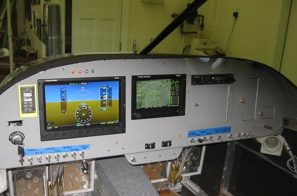

Cut holes in panel for my two Skyviews. Main 10" and pass 7" . I understand updating the skyview with a thumb drive is needed. I wanted to put a connection point on the instrument panel for this drive. ( I see Garmin already did this with their new EFISs.) What have you done to accomplish this? Will I need two Locations or just one? Pics helpful too!

The DYNON Skyview displays have two USB ports in the back of each display. However, getting to them to update the display can be a hassle. I connected a 12" USB port extension cable from one of the available USB ports on each display to a panel cut out just to the lower left of each display as seen in the picture.
Some people just connect the extension cable to the display and tie wrap them somewhere under the panel where it is easy to get to. Just do whatever is best for your airplane.
