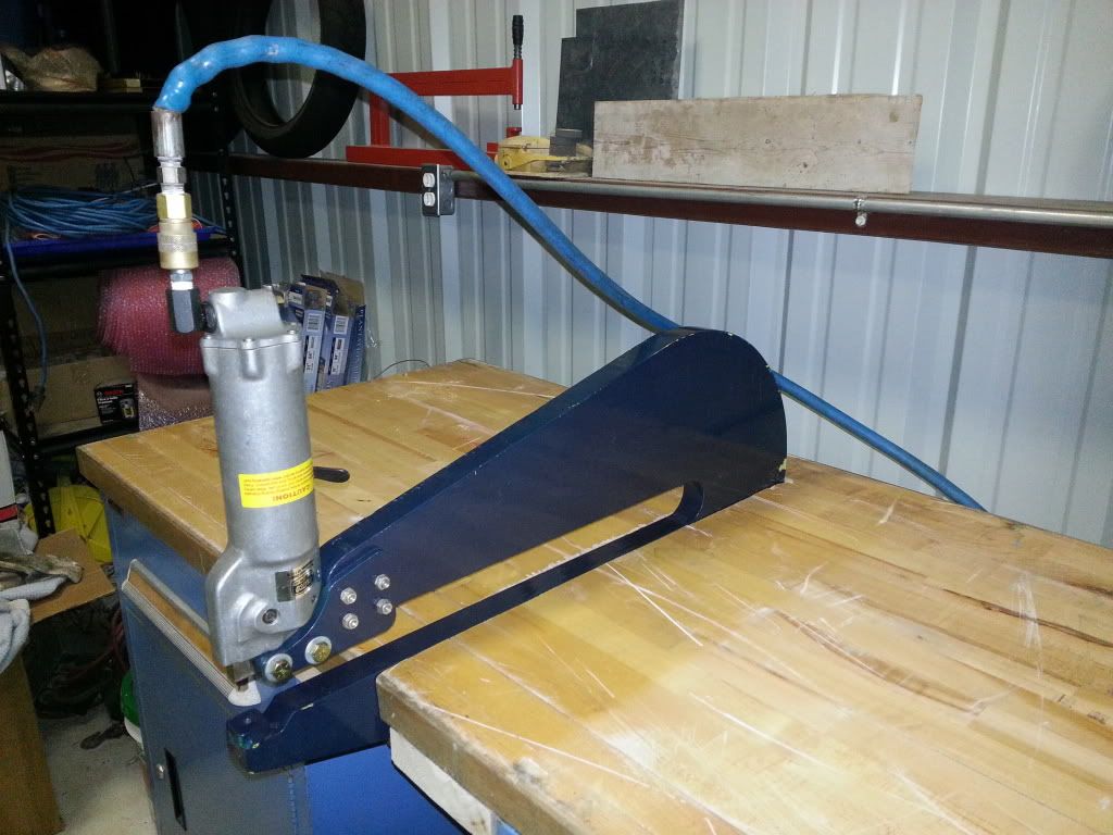

Here is a picture of my C frame with the 3060 squeezer from Numatx. I epoxied the bottom plate in place instead of welding or screwing in place.

I put on two hinged leaves on the bench to extend up for dimpling skins.

Hi Ken - Did you construct the C-Frame and Table using Numatx's plans? I took his drawings to a metal shop a couple of years ago and it was going to be close to $1,000 for them to build it for me. I know he's redesigned it since then, so maybe not so much now.

Yes, Ken built the C-Frame from Numatx Plans (dwg 3430). There are 3 versions available:
1. 3422 - C-Frame waterjet cut from 1.5" thk plate steel.
2. 3430 - C-Frame which will directly accept Model 3060 C-squeezer
3. 3440 - C-Frame which mounts a Model 3400 powered head.
An adapter plate on dwg 3440 allows the 3400 powered head to fit the popular DRDT frame as well, for those that already have a DRDT frame. The 3400 powered head, is redesigned for part commonality with the 3060, which means you can buy the mount block only, and screw in the cylinder from the 3060 when you want to do dimpling or light riveting. Or you can buy the complete 3400 head, if you prefer not to be screwing the cylinder in and out. Your choice.
The $1,000 you were referring to was for the 3422 waterjet version. The price you were given sounds a bit high, but that may have been a polite way for the machine shop to say "we are too busy to do the job".
I purchased a 60" long 3" x 6" x 1/4" wall CRS tube, which is what it takes to make a 3440 C-Frame. This tube was a drop-off purchased from Alro Steel for $40, in virgin condition. I asked on a price for ordering the steel tube, and was told $90. There are a couple of other small steel pcs to complete the frame, and of course the tubing needs to be bandsaw cut square and welded.
Pictures and a video will be posted on the Numatx website when the C-frame unit is completed.

I purchased a steel plate from a metal recycler for .25 cents a pound which was a little over 100 lbs ($26.49) and took it and the 3422 .DXF to a machinist to have it cut. They said they would do it for $200 if I wasn't in a hurry. A month and a half later I picked up the C-frame and gave them a DXF I created to use the common CP-214 squeezer. After about 45 minutes I was headed home to throw the brackets on the Bridgeport and cut them down to hold my squeezer. It took some time and a few email exchanges with Mark (thanks again), but I would say it was well worth it when dimpling the ailerons and wing skins. I have to say Marks generous gift of these free drawings that he put hours and hours into designing has saved me a ton of time and shows the great people we have in this hobby of ours. I have a video of me using it to dimple the aileron and how fast it is on my phone, I will try and get it on youtube this week. Here is a picture of it while I was constructing a table for it. Sorry about the large picture, it won't let me bring the size down.

so far the 3060 works great. i have not used it attached to the Cframe yet, since there has been opportunity to need it yet on the wings. I will as soon as I start to dimple the skins.
My father-in-law and brother in law built the Cframe. they bought the metal and had a machine shop cut up the pieces. they then welded it for me. I made the bottom plate for to hold the dies and epoxied it in place. That was easy. I think that the metal coast about $200 and $50 bucks or so to cut out the part that holds the 3060. It took about 1.5 hours to weld. My father-in-law and my brother-in-law were/are professional welders.
I am sure that they would build them for much less than $1000. Not sure how much it would cost to ship one of these things. It has to weigh 75 lbs. They live in VA.
If anyone is interested I can ask if they are interested in building another one. The other alternative would be to have a place cut the metal, then advertise on craiglist's list for welding services.
The table was my own design. Essentially an EAA table attached to the wall. Well two tables with an inset for the cframe between the tables. And then I put on leafs that I can put up for dimpling skins.
