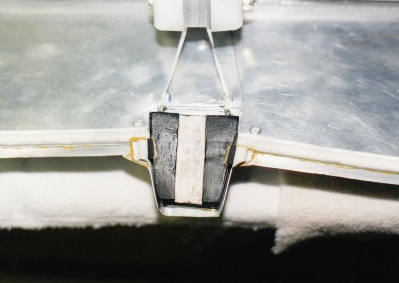

  #20
Old 09-09-2013, 10:49 AM
Posts: 5,685
Default A fix for the cold/air/rain hole in the back
The black part is balsa wood sheet s selected and glued together to fit the rail. The outer surface is cut and sanded to shape to fit my aluminum cover fairing. The white is "P" strip bought from Aircraft Spruce that is glued into a recess carved into the balsa wood plug with 3M weatherstrip adhesive. The pull string is nylon wire bundle lacing tape (string) bought from Aircraft Spruce. The pull connections on the plug are .020 safety wire passed through the plug bent over in a "U" shape and pulled back into the plug to prevent pullout and an attachment loop is formed on the other end. These photos were taken in March of 2003, 1 year before the first flight of out RV-6A. Today is September 9, 2013 and the plane has well over 1000 hours on it and it works perfectly. One change I made is to put plastic tubing (wire sleeving) on the pull strings.
Bob Axsom
