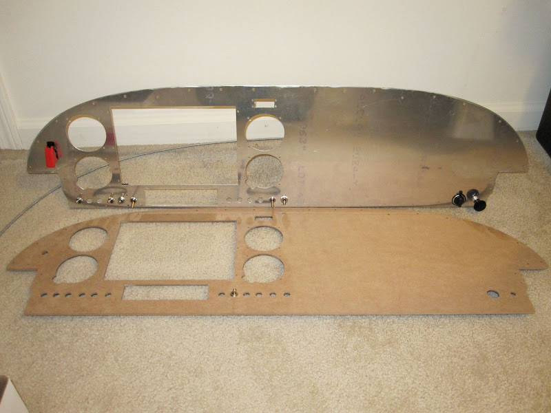

I used a homebuilt machine for some work. It isn't super fancy or super expensive, but did what I needed it to do.
