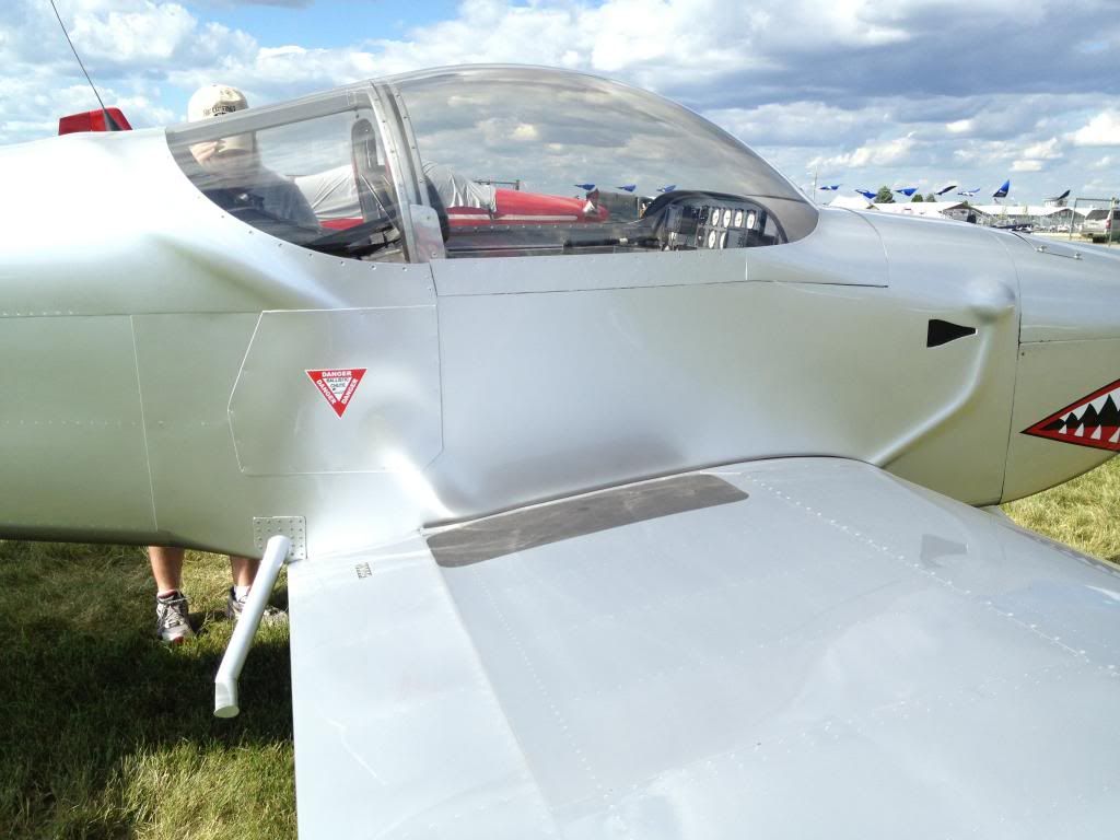

Here are a couple of photos of the BRS installation.
[IMG]<a href="http://www.flickr.com/photos/bacstabber/9472957368/" title="IMG_0152 by Jack Clark, on Flickr"><img src="http://farm3.staticflickr.com/2811/9472957368_c27bc48047_c.jpg" width="800" height="600" alt="IMG_0152"></a>[/IMG]
[IMG]<a href="http://www.flickr.com/photos/bacstabber/9472957786/" title="IMG_0154 by Jack Clark, on Flickr"><img src="http://farm6.staticflickr.com/5449/9472957786_3da82835f3_c.jpg" width="800" height="600" alt="IMG_0154"></a>[/IMG]

Thanks for those pics Jack. I didn't see that 7-A at Osh.
What I DID see was BRS in their booth in one of the hangars, where they had a 7/9 fuselage (no wings, no empennage, no FWF, no gear) set up and showing their solution. It was not completely unlike your pictures, with the following differences:
The front strap attach point was at the firewall (like in your pics), but the strap was faired along the side of the fuse rather than apparently traveling through the wing root in your pics.
The fairing for the straps was a bit different. Less "rounded" and more square and trim. They didn't have it finished/painted, so final appearance not evident, but like others have said, it looked like it could be well hidden with a good paint scheme.
The 7A in your pics appears to have a side discharge out of the baggage compartment area, whereas at the BRS booth it was side discharge out of the fuse behind the baggage bulkhead. The solution in your pics may help with CofG issues, but use baggage space.
It's not really evident from your pics, but at the BRS booth the rear attach point for the straps was to a bulkhead behind the main baggage bulkhead (they wanted it back far enough not to interfere with a slider mechanism). It attached centrally to the top of the bulkhead, but then had stringers in a triangle to tie it into the two bottom corners of the bulkhead as well, along with some beefy looking attach points added at the bottom corners.
I'm wondering if your pics of the 7A is someone's "home brewed" version of installing the chute, and BRS is now looking at providing a kit for a "standard" installation? I think I saw pics quite awhile ago of a 6 that someone had installed a chute on as well?
I have no editorial comment on the usefulness/need of a chute. I'll leave that to others with the time/desire to enter into it.
