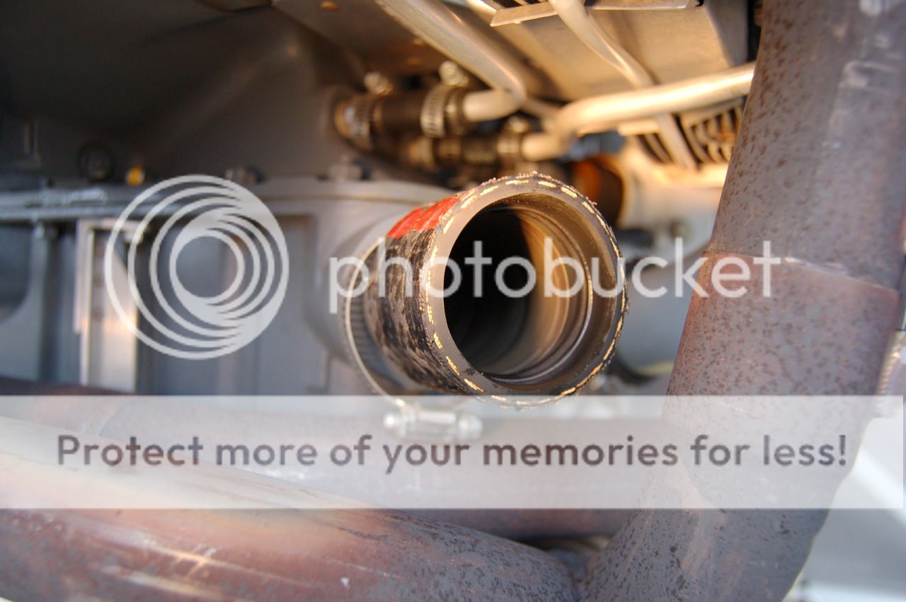

Set of gaskets started leaking again after almost 550 hours on them.
The procedure is simple and doesn't take much time.
Scrape old paper, clean, degrease. I left light coat of titeseal on one old gasket and it was very easy to remove RocketBob was right. The intake hoses are kind of hard. Do they have a lifespan?
Innards of cylinders get cleaned up lots of lead there.
Plugs cleaned and regapped.
Good to go. Vroom! Engine works like a Swiss clock

Across many forums and this one included....plugs gapped EVERY 50 hours to 0.016-0.018" and the inlet gaskets........wel they seem to last 250 hours And that is sad to say.
Last weekend I found two intake leaks on a RV7 that had 140 hrs.
If it helps the red SUPERIOR gaskets seem to last longer.
Glad you are onto these things!

David do you know where to order red SUPERIOR gaskets from? ACS seems don't have them. Also I would appreciate part ## on intake hoses. I would like to replace them they became very hard and edges are crumbling. O-320 here

I thought Aero-in-stock have Superior gaskets but they sent me regular. So far I tried three different supplies of intake gaskets. All leak after couple hundred hours. Or maybe I install them wrong.
I also bought and replaced intake hoses. They look very funny totally deformed but didn't leak.
All new.
