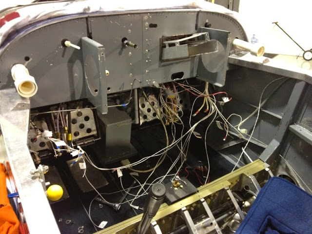

Default Another pic...
And one "in-between" pic.
YIKES!!!
