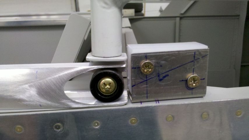

This is yet another problem with my quick build fuse that was built too wide at the front roll bar area. Keeping the roller tracks parallel the over hang at the rear is greater than plans show. After removing material to clearance the tracks from the side skirts I'm left with a notch that the rollers will get caught on.
I'm thinking of making some kind of stop about an inch before the end of the track. Has anyone else had this issue?

I think the Stop an inch forward or so is the way to go.
Get another plastic block, shape it to fit inside the rail, 2 counter sunk screws from the top and you should be good to go. As always tho theres a million ways to skin a cat.

Just use two pieces of fuel hose from your favorite automotive store and make them 1.5 to 2" in length, place them in the track behind the roller and put some aluminum tape, we called it speed tape back in the day, to cover the notched out area on the track. It will keep the hose in the track in the aft section, just get the right size hose, it will be a tight fit and you will need to squeeze it in there. The AL tape is covered by the slider side skirts. Hope this helps...

I inadvertently removed too much as well. Didn't really need to and mine hangs up as well. I haven't fixed it yet but I didn't want to limit the movement to the rear. It seams the space between the seat back brace and canopy is a limiting factor for large objects in the baggage area and I did not want to limit it futher. I am thinking that the fix may be to insert a thin piece of aluminum plate in the track to cover the hole from the inside. Maybe glue or epoxy in place.

Simple stop I created to solve the same issue
Before trimming
